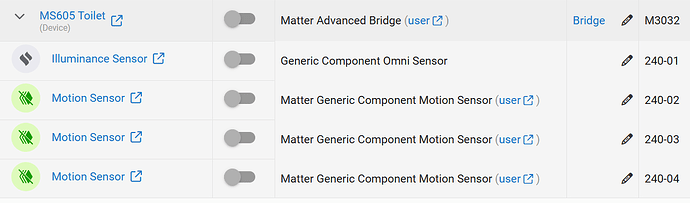

(Not sure what you mean by unstable driver - your first comment about a suitable driver not being available is correct ... the Custom Advanced Matter Bridge driver was updated later to cater for the MS605 and has been working flawlessly since then!)

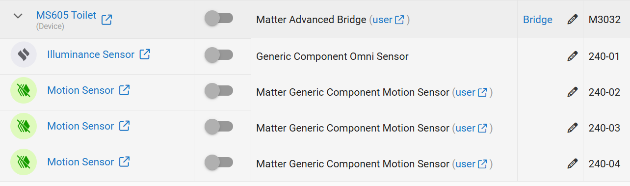

Just successfully added MS605 to C8 with v2.4.3.177 as a test:
