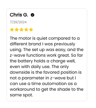

I'm going to be purchasing 8 sets of the SmartWing roller shades soon. I see they have zigbee and z-wave. I would prefer z-wave as my entire home is z-wave so I think for mesh purposes this would be best for me. I did however, see this as a review and is concerning. I do want to be able to set a certain position that is halfway open and so shades that are side by side are perfectly lined up. Can anyone confirm that this is true? Is there an option to open to xx% or do you only have open/close/stop commands?
