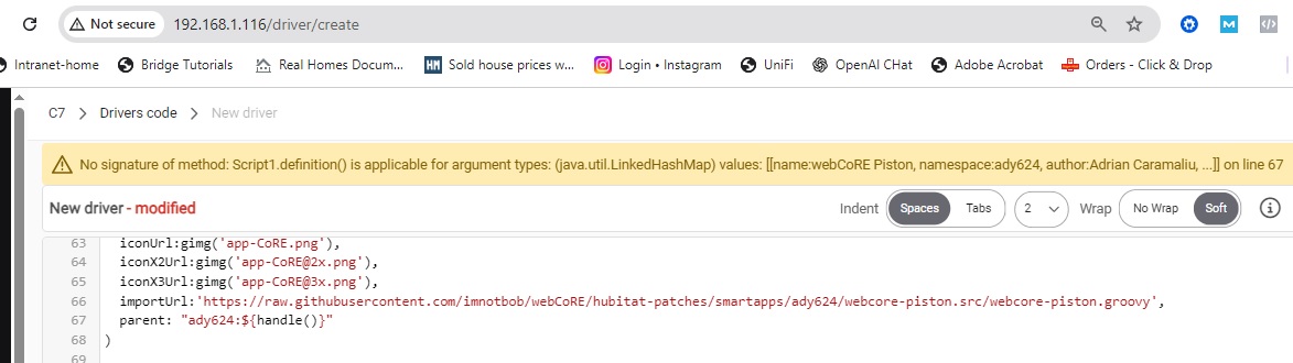

It appears based on the detail below the code is the issue not HPM
Looks like your manual import is trying to add a app to Drivers Code instead of Apps Code. And if you're updating it, it should already be there (and you can re-import) rather than adding a new.

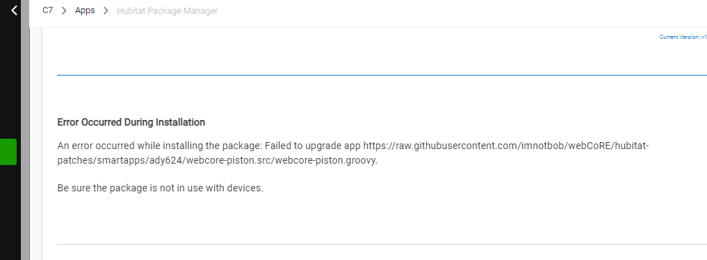

Thank you, I just ran HPM again, it failed with this message

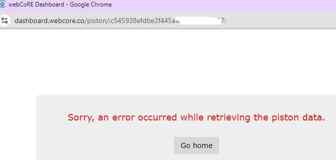

Now when I try to view a piston I see this
Piston
I hope that's helpful data,

I would check Logs as suggested, not the app UI. It is a large app that may take some time to install, but on recent platform versions, I think HPM (and manual) still works.
The error in webCoRE itself is probably something else unless maybe your app code is very old. The code will either install or not; if it errors out, there's no "partial" state where it can get stuck causing an error (at least for any single app). Trying a different browser, clearing cache, and other common steps for troubleshooting that kind of problem may help.
It's a long standing problem with the size of WebCoRE vs the Hub's timeout. Said another way, the upload+compile time exceeds the timeout. BUT the timeout is in the Hub code, not HPM.
That's very very simplified and someone with better search skills than me can find that discussion, I'm sure :smiley:
