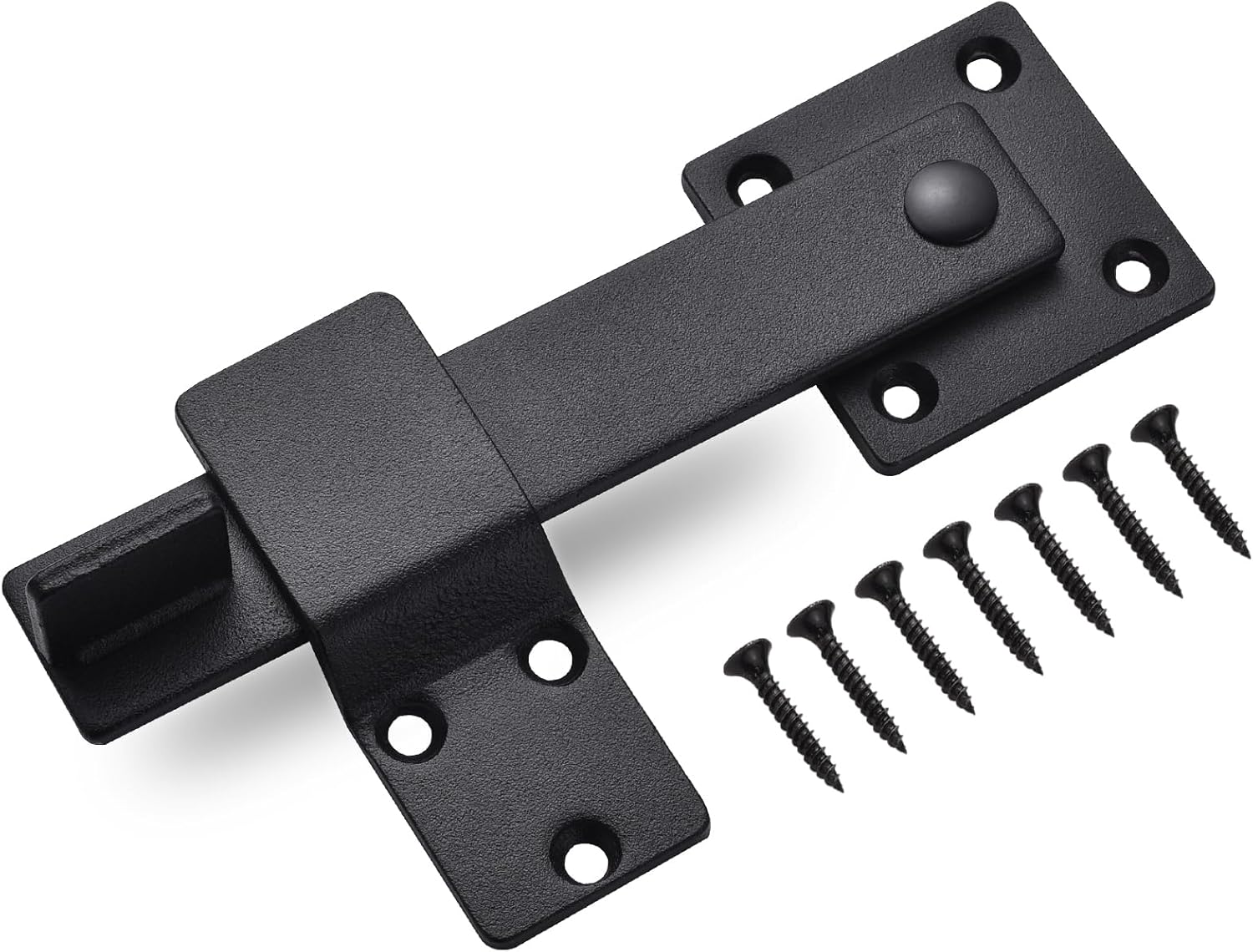

More input: so I'm thinking something like this latch:
where the pivot point is coupled to something like this (which in turn would be coupled via the ball-chain to the Zigbee motor):

I'm going to try the blinds motor as an experiment, it's fairly cheap. Note:
  • The gate is close enough for Zigbee comm (I already have a magnetic contact sensor on it that works).
  • The motor only needs to pivot a "free fall" latch that does not weigh more than a few ounces.
  • The blinds motor already has an internal battery (claimed to last months) AND a solar charge panel.
  • The gate already has a manual security latch if need arises to positively lock the gate (and that latch cannot be activated from outside the gate, which leads to a public sidewalk).
I will need to craft a linkage between the motor an the pivoting latch, plus a waterproof enclosure for the motor, but I think those are within my (admittedly limited) skill set.
