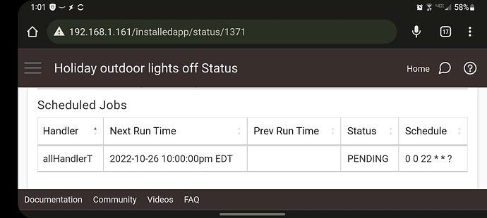

I have a GE outdoor plug and an Eva Logik outdoor plug that are not turning off when they should. They turn on at sunset -90 min, but do not turn off at 10:00 pm as scheduled.
I created a basic rule to turn them off at 10:00 and that didn't work so I created a rule with rule machine and that still does not work.
It's tough for me to decipher mobile screen shots but if I read correctly there nothing in the logs to indicate that the device was commanded to shut off at 10. What is turning outdoor outlet 1 off at 10:28? Are you doing that from the devices page? And do they turn on and off as expected from the devices page?
As a next troubleshooting step I might try removing the "command only switches that are on" to see what happens, and turn on logging for the rule itself.
I will give that a shot. This is the second rule I have tried already. The first rule was a basic rule and that didn't work so I created it through rule machine and it's still not working. I will delete it and try again for the third time.
This is a very basic schedule and failure is extremely rare. Your idea to run this in Basic Rules makes perfect sense and that is what I would have done too.
Everything you've shown so far doesn't explain why it failed. I've been watching your thread with great interest. If you'd like, you can send me a private message with your hub id and we can take a look to make sure you are not dealing with some kind of database issue.
