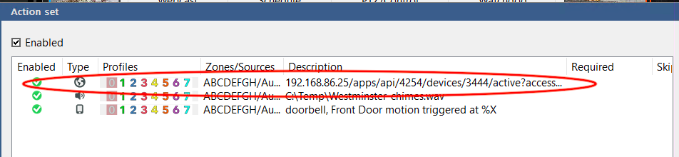

I'm sure there is buried in this or the ipcamtalk forum somewhere, but it's pretty simple to do.
  1. In HE setup virtual switches for your cameras.
  2. Setup the built-in Maker API app in HE to include the virtual switches in step one.
  3. Go into your camera settings in BI and click on the alerts tab.
  4. In the "Actions" section select "On alert..."
  5. Click on the plus (+) to add a new action.
  6. Select "Web request or MQTT"
  7. Copy the Maker API command that was created in step two and paste it in the http:// box making sure that you use the correct device ID and associated command for the virtual device you created in step 1.
