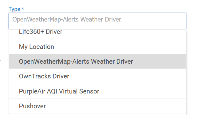

Sounds like your virtual device is NOT using this driver, but is using the integrated driver. When you select the driver make sure you scroll all the way to the bottom to the 'User' driver section and select OpenWeatherMap-Alerts Weather Driver

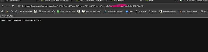

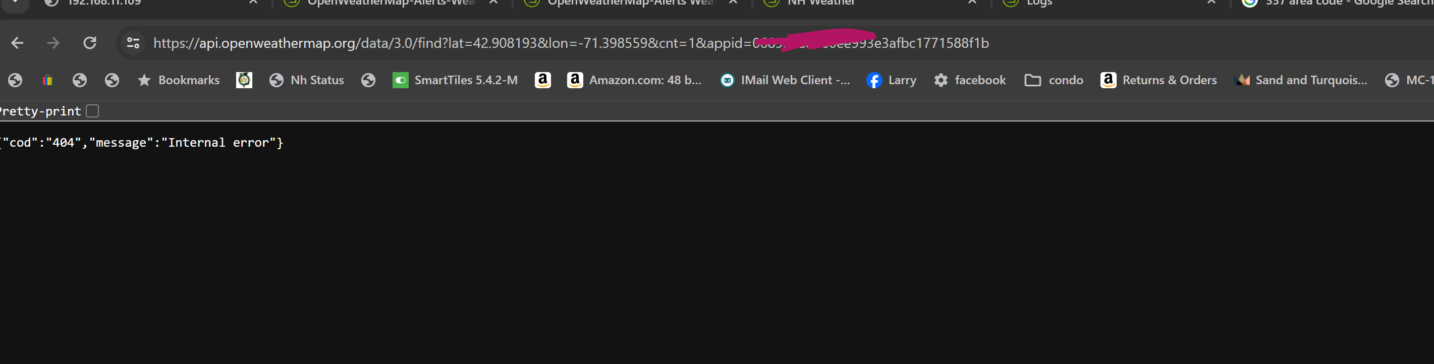

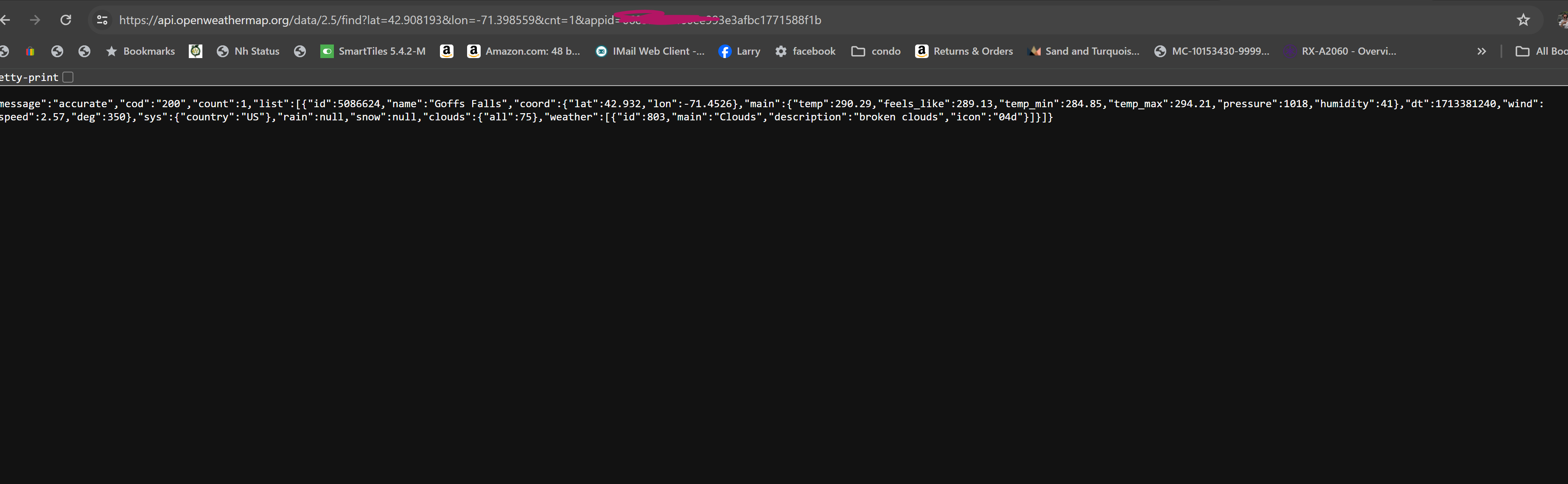

here is no error in the logs.. the way the code is written if there is an error it ignores it.. but it is not working.. if you print out the url and manually call it.. it works with 2.5 in the url but 3.0 gives an error
same.
To all using 2.5, besides changing the 2.5/3.0 select button to 3.0, I needed to go to the subscriptions page to subscribe to One Call 3.0. You have to enter a CC but you get 1000 free queries. After subscribing I set my maximum number of queries to 999 to make sure I stay free.

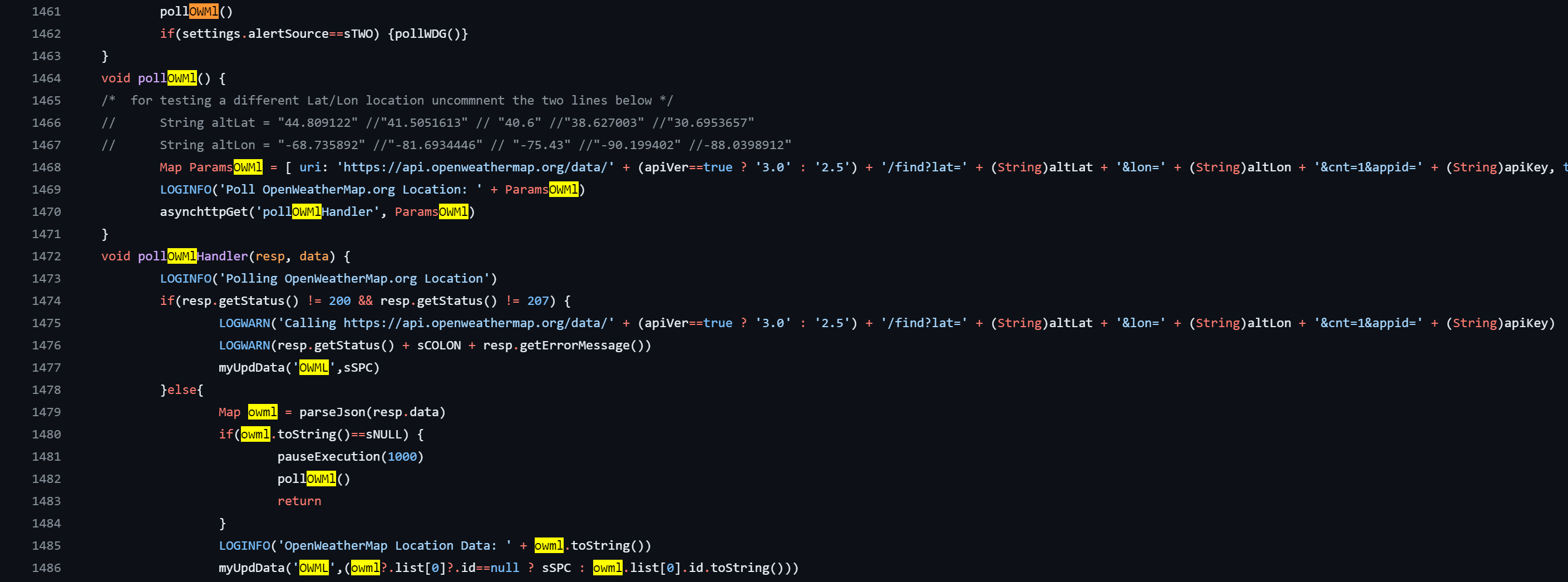

logs complain about /find? being 404 after you change to 3.0 and save the device. but it doesn't seem to affect anything- all seems to work fine.
here you go.. from what i see this call will no longer be supported and you need to use the
/geo call but i dont see it returning an id..
the only similiar call i see documented is this
https://api.openweathermap.org/geo/1.0/reverse?lat=' + (String)altLat + '&lon=' +
etc.. but it doesnt return an id.. only the city name etc
Do you have an active 3.0 API key in addition to a 2.5 key?
yes i had an older 2.5 key .. that is still working.. it is strange that the url works with the 2.5 mnemonic but with my 3.0 key.
