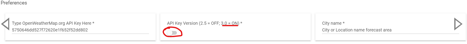

Also, looking at your device setup, you originally had it set for the 2.5 API key. If you just created a new API, it needs to be the 3.0 version.

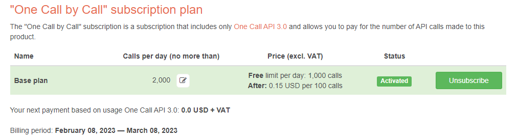

Hey all,
Fairly new to Hubitat - had one for a while but just shifting over some from Smartthings.
I've looked into this - but what makes me really nervous is that when I go to Weather API - OpenWeatherMap
to look into an API key - when you hit 'Subscribe' on the left (under One Call API 3.0 new) it takes you to a page that that says "\ "One Call by Call" subscription, Base plan, 0.15 USD per 100 calls (VAT is not included)".
When I select "Subscribe to One Call by Call" under 1,000 API calls per day for free
0.0015 USD per API call over the daily limit"
It takes me to the same page - " Base plan, 0.15 USD per 100 calls (VAT is not included)
  • so - no mention of the 1,000 API calls per day for free. Or a minimum.
Feels a little bait-and-switchy. I guess, supposing I did under 100 a day it wouldn't be that expensive -but I don't need yet another subscription in order to manage my outdoor weather-related routines... unless I do?
Is the 1,000 API free API calls a day a thing? And if not... why are they advertising it? (so, maybe I'm naive!).

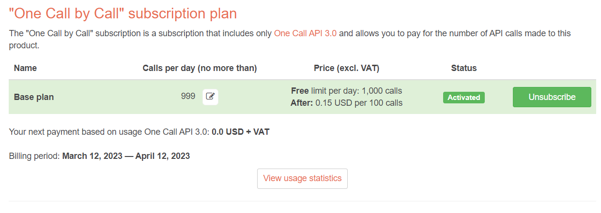

That line does not make it too clear but
Base plan= 1000 calls a day
Exceed 1000 calls and you'll pay $0.15 for every 100 calls after that.
My billing page is a little clearer.
BTW, I've never made more than 80 calls a day. The data doesn't update but every 10 or 15 minutes anyway.

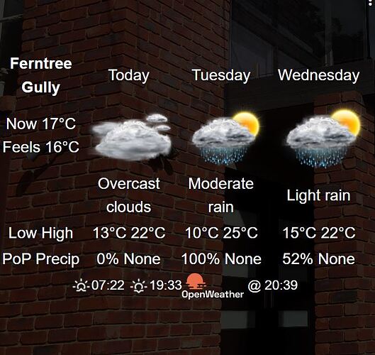

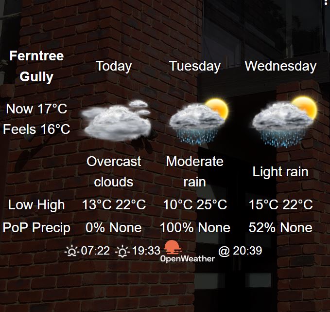

Has anyone encountered partial data not being changed recently? I setup an automation to monitor the alert driver because my municipality introduced a new regulation saying we can't run any outdoor irrigation within 2 days of rain. Since my Rachio system can't handle this kind of restriction, I built one with RuleMachine polling the OpenWeatherMaps-Alert and it had been working up until a week or so ago.
The field I have been monitoring "RainToday" used to change, but it's stuck on "0".

Yes.
The threedayfcstTile hasn't changed since last week.
Edit: forced a refresh and it's now current

If, after you sign on to your account, you go to: https://home.openweathermap.org/statistics/onecall_30
This will show you a log of your call statistics. I'm averaging around 90 daily calls. The maximum number of calls you can make without being charged is 1,000.
You can also set an upper limit of calls by going here: https://home.openweathermap.org/subscriptions
I have mine set to 999 to automatically prevent me from ever getting charged.

As I mentioned in my original response to you:
You have to have an account and One Call subscription already set up and then go to the link above to set the upper call limit per day.
It will look something like this (note the '999' entry:)
Dohh, :sweat_smile: didn't realize that was editable field. I thought it was just displaying how many calls a day. Thank you again.
