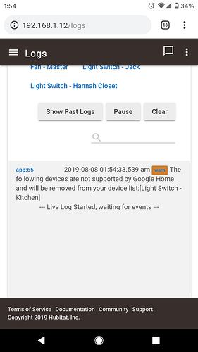

I have a problem with one of my many GE zwave plus dimmers in that I add the device to the Google home app, update, save and it disappears from the list!
I looked at the hub logs during this attempt and see that there is a not supported message. Does anyone have any suggestions for me on how to get this working? I changed the device type to another and back, same issue. Confirmed I have others with the same model and device type. I also removed and added the others to Google home and they stick.

What is interesting to me is I can add the device to the google home app, save, then imediately come back into it and see the device listed. Then as soon as i say "ok google, turn off light switch kithen" it disappears.
I have also tried adding it -> "Ok google, sync devices" -> then trying to control it and seeing it disappear.
I am going to try adding it again, but not trying to control it with my voice so i can tell if the voice command is triggering the removal or if Hubitat\Google talking behind the scenes does it.
please post a screen shot of the driver current states for this device...
The GH integration rejects devices that don't have attribute values for the published capabilities.
yup, there is no state for switch, that's the issue...
