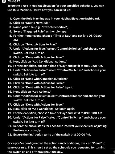

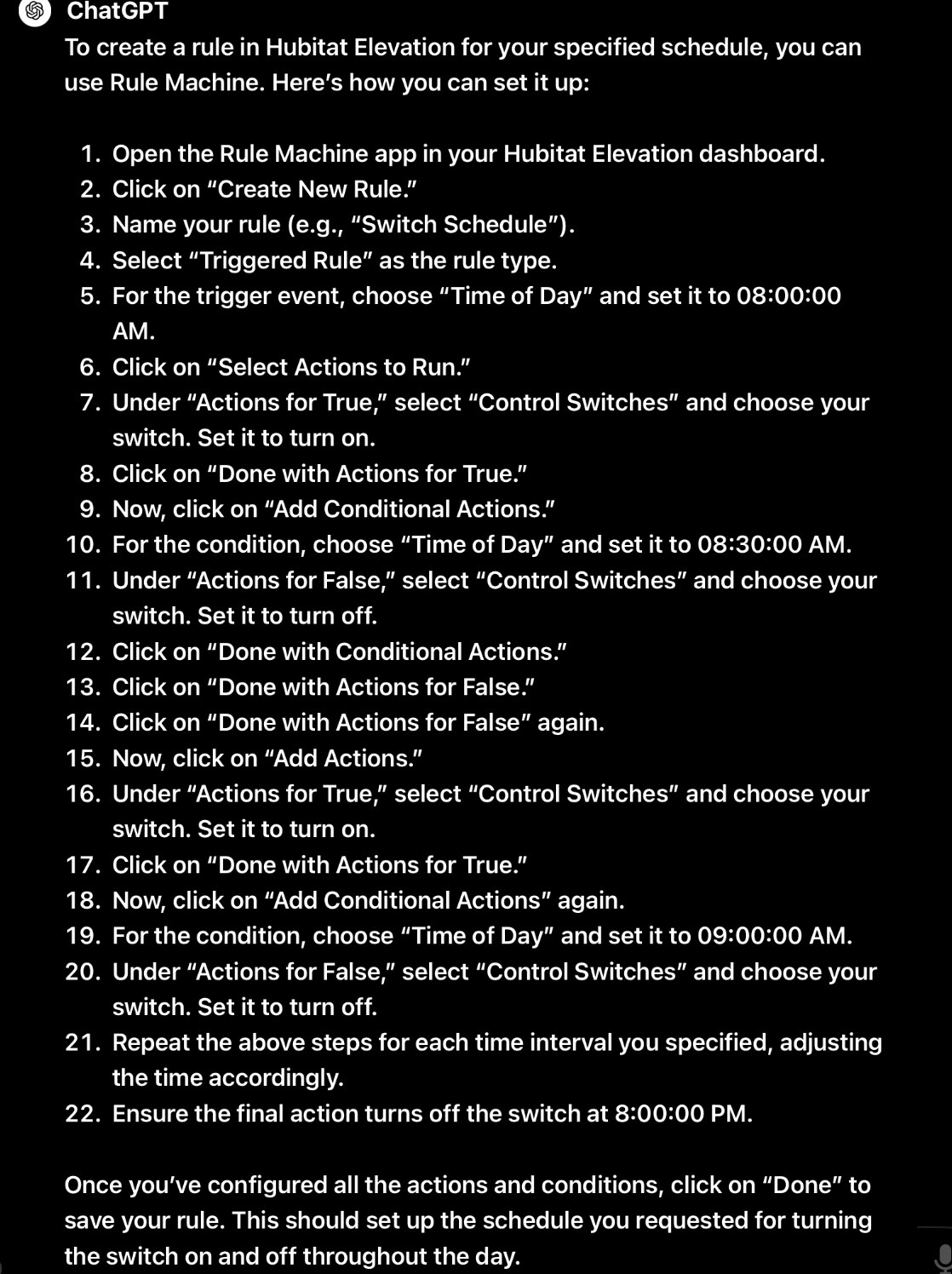

I looked in HPM and made some rules that don’t work due to my limited knowledge.
ChatGPT was not helpful

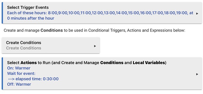

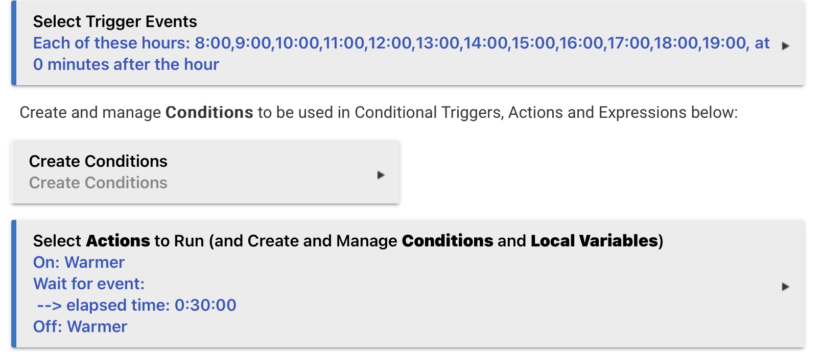

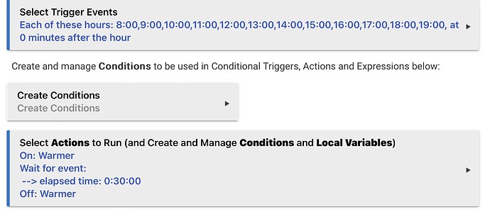

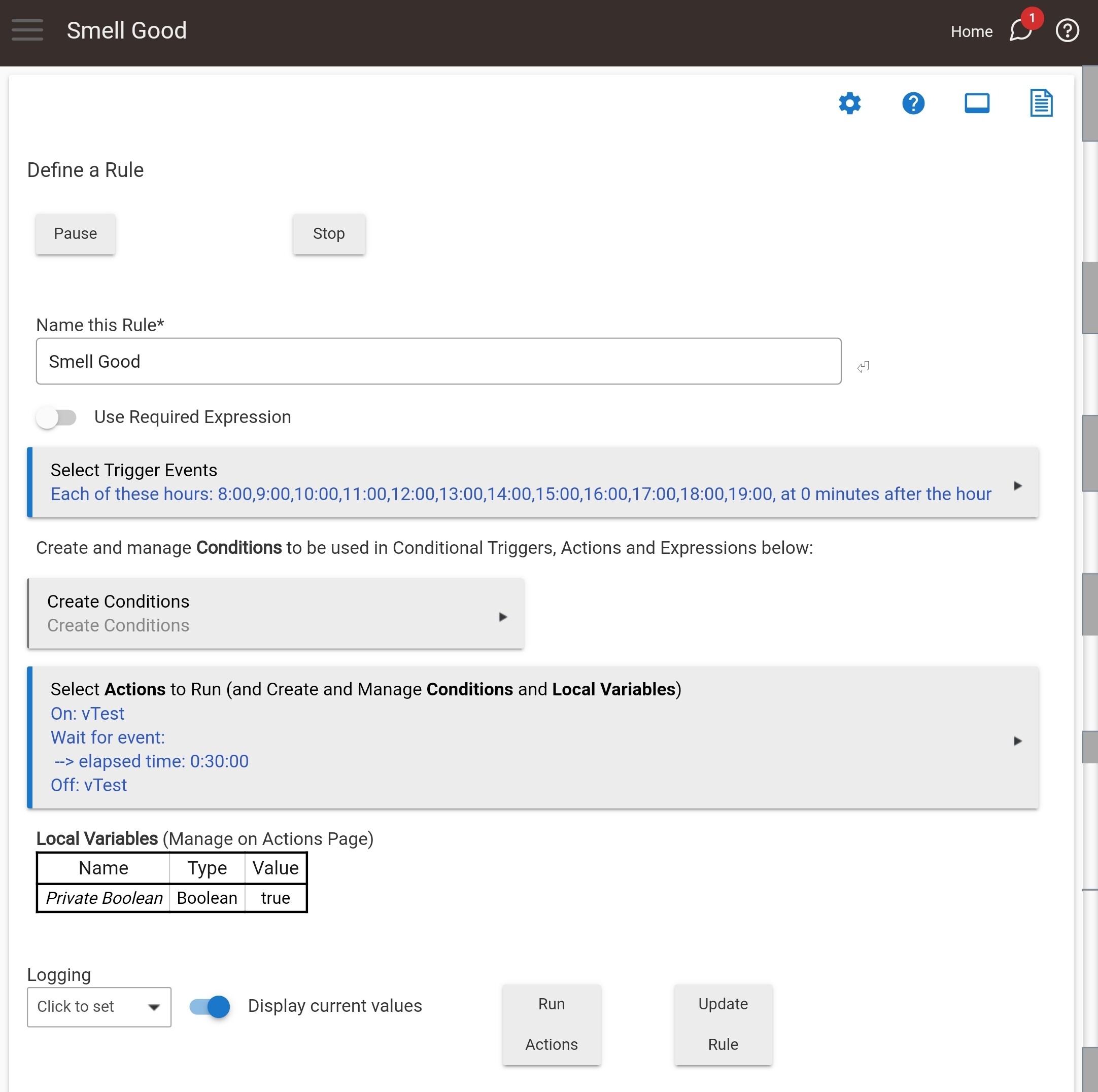

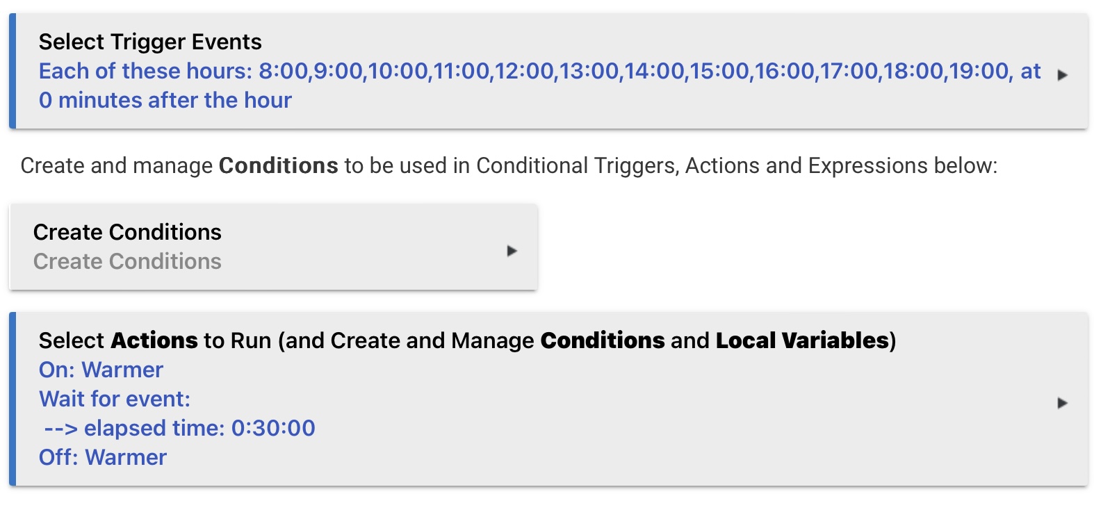

How does this look? Uses a periodic trigger to keep things simple.
I was reading too much into it.
Thank you. Coding is not in my genes.

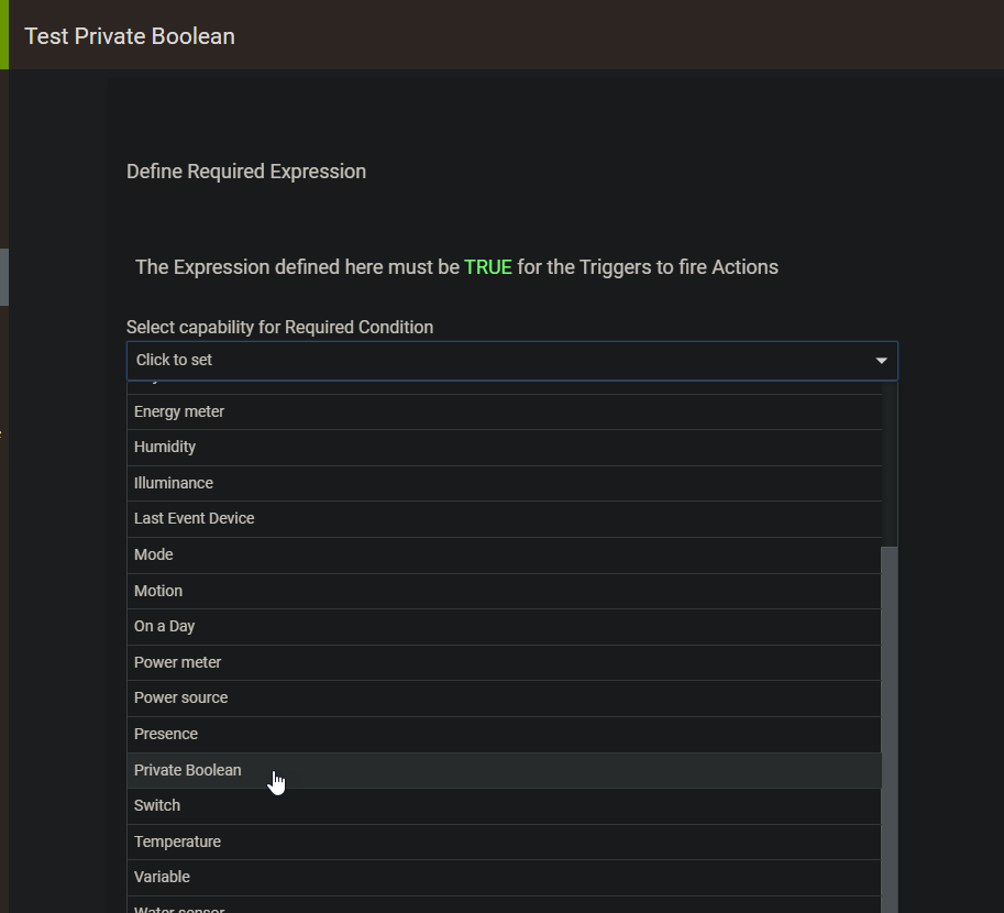

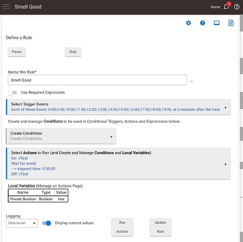

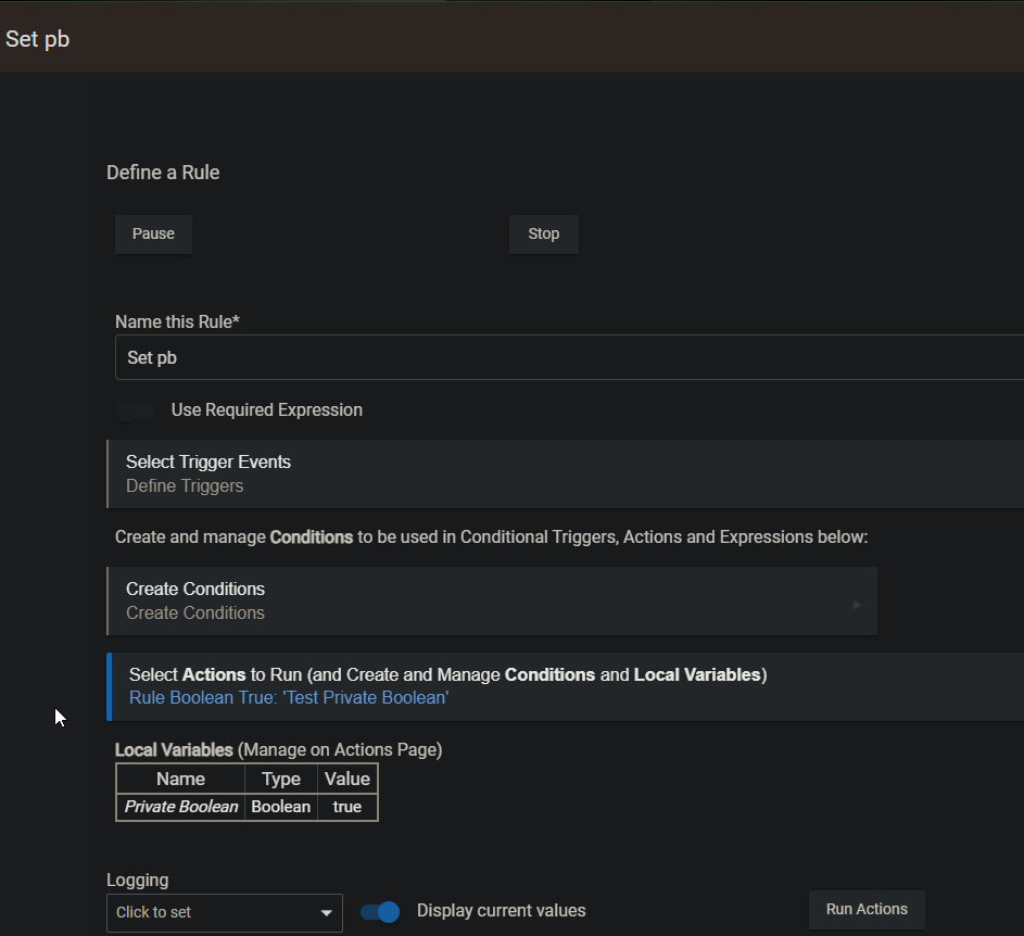

You may want to introduce a required expression to allow you to override the running of the rule, in case you don't want to run it for any reason.... Obviously the practical side to me says "just unplug it"... but where's the fun in that... :slight_smile: You could either use a private boolean and set that in a rule based on a button / switch, or setup a virtual switch / button you make available on a dashboard, or use a physical button.... many options... Just a thought...
Seriously, I have a mental block.
I'm heading that way... :wink:
The PB is likely the slightly less convenient option....

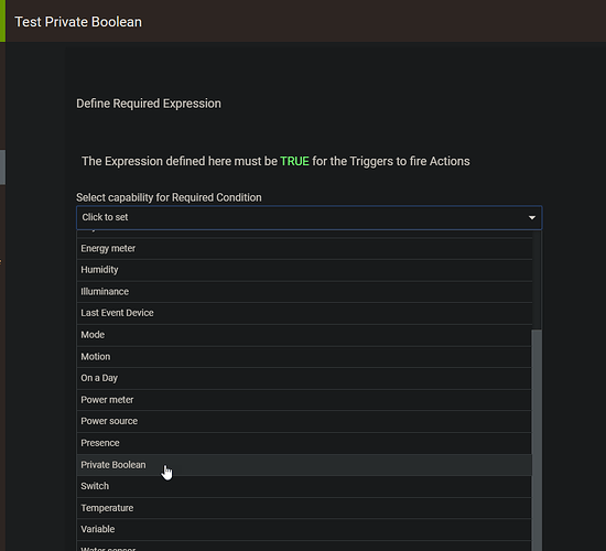

Click through the various options required to enable a required expression and create a new condition... Then select:
Use true / false, whatever suits you.... And click Done, Done, Done...
You can then, in another rule or automation app, set the private boolean....
Alternatively, I would personally use a switch / button due to the versatility with dashboards, the app, Maker API... etc
Regardless of the option you take, you will likely want to manage resetting the option at somepoint, e.g. overnight or on mode change, whatever best suits.
