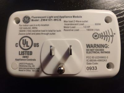

New to HE, just now and still migrating from Vera. Have come to discover that none of my older GE/Jasco appliance modules work on HE, no matter what generic z-wave outlet driver or switch I try. The "Generic Z-wave Outlet" driver that is ALWAYS selected when this device is included can switch them on/off, but if I switch them on/off at the outlet, nothing is reported back to the hub and its state is not changed. Z-wave log shows no activity when I manually switch them. There is no factory reset on these outlets, only exclude and that is working fine. I can include/exclude these things all day but they don't work. Frustrating to think I need to invest in all new outlets because these 7 outlets form the backbone of my z-wave mesh. What gives? I see a lot of problems with these ge/jasco devices out here.
The GE model number is ZW-4101-WCS. I don't know the Jasco number.

That is the key word. These appear to be 2009 era Z-wave (non-plus) devices going by the date code and the old Z-wave symbol. These older Z-wave devices don't send their status to the controller unless polled. There was a patent infringement issue with another automation protocol (Lutron?) where Z-wave could not include that instant status feature.

That said, this not reporting the correct status is the expected behavior for this device that drivers and the hub itself cannot fix. The best you can do is poll the device, which has downsides like consuming resources and potentially not being quick or accurate as a more modern device that does report its status.
