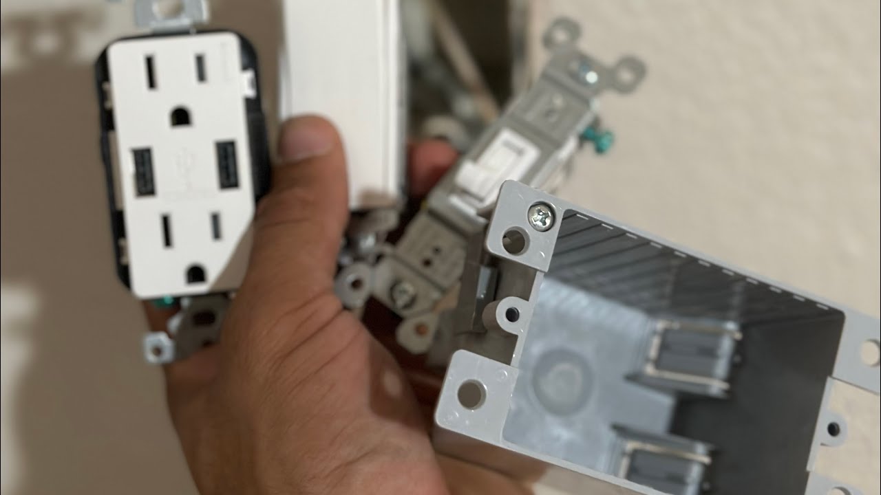

Regarding removing gang boxes, I helped a neighbor do that quite a few years ago and IIRC, we killed the circuit (DOH! :wink: ), removed all switches, straightened and pushed wires out of the way as much as possible, and got a hacksaw between the box and the stud and cut the nail(s?) holding it in place. Was about 15 years ago so memory is a little foggy...
This looks similar to what we did...

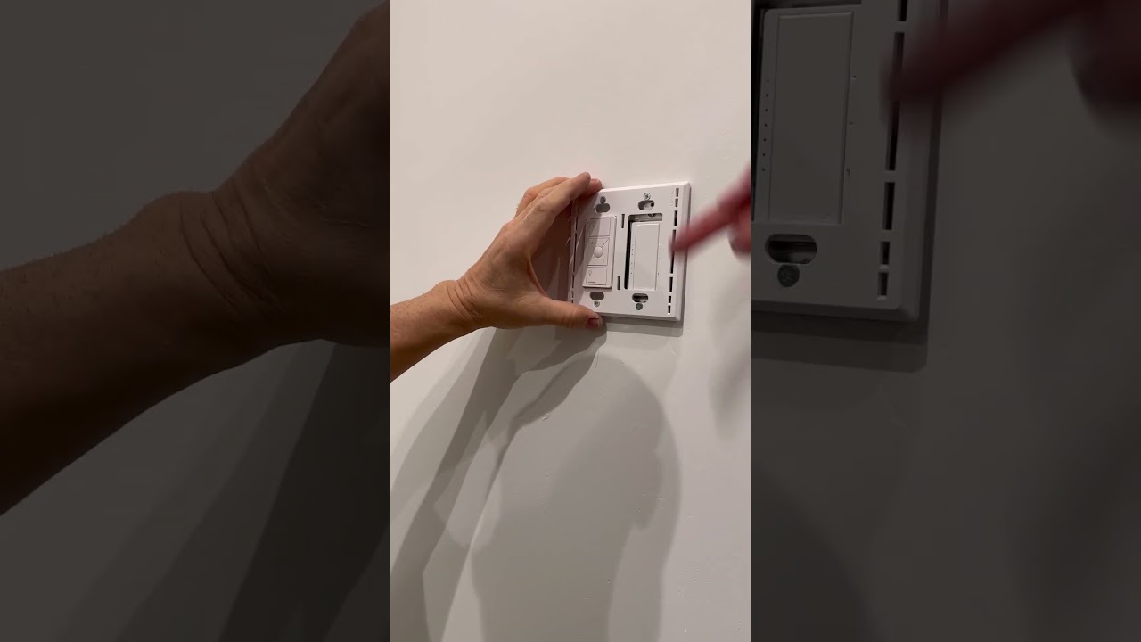

That's really easy without having to modify the box or wiring at all. If your wallspace allows it, just use a 3-gang wall plate instead of the existing 2-gang wall plate. The pico remote, with the proper wall-mount accessory kit, can simply be added to the additional 3rd location. I have done this in multiple rooms of our house to have a wall-mounted Pico that controls table/floor/night-stand lamps. It is a very nice clean look, with no modifications to the electrical box required.
This video shows an example of doing this.
I don't even bother with adding the drywall screws he used in this video, making this change very easy to reverse, if desired.

I've done this about a dozen times in the last year. Here's a procedure that works:
  1. Determine which side of the existing box is attached to the stud.
  2. Create a template using the replacement workbox. I made the template in plastic so it is durable.
  3. Remove switches, etc., and then center the template over the existing workbox and mark it out.
  4. Use a drywall saw or oscillating tool (preferred) to remove the excess drywall around the existing workbox.
  5. Use a wooden dowel and rubber mallet to knock the existing box away from the stud by 2-3 millimeters.
  6. Use an oscillating tool and cut the nails.
  7. Remove the old box from the wall.
  8. Pre-drill two small holes in the new (plastic) old-work workbox on the side that will be abutting the stud. After positioning the box appropriately, use 3/4" screws to affix the box to the stud. Doing so makes it much easier to deal with the box in the future. It will stay in place.
1a. Take lots of pictures (in case you can't remember where the he :ice_hockey: :ice_hockey: all the wires went). :grimacing:
Labels are good too. :thinking:
