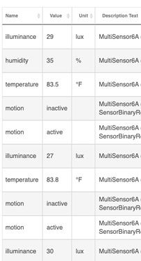

Look at event logs for those sensors. Open the Device page for it, at the top is Events. Click that and you'll see a list of events. Here's one of mine over the last 6 minutes:
If you're not seeing the Events then the Sensor's messages aren't getting through. Many of the screenshots requested will help us help you with advice to narrow it down.
Is the Sensor's message arriving? Is a Rule being run in response? Is the message to turn on/off the light leaving the Hub? If you use the device info page for your lights, so they function 100% of the time? Logs will help with those questions.
