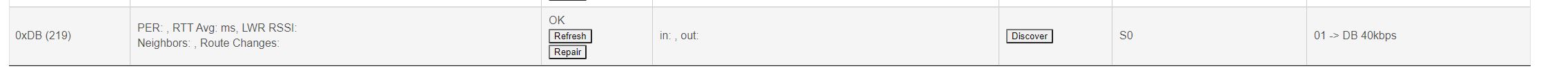

How long do you wait on the Initializing step on the dicover page? I've had devices pop in up to two to three minutes after that initial Initializing message appears. Maybe try setting a four minute timer next time?
Also, when you get into the state below, how many times do you bang on the Discover, Refresh, and Repair buttons?
I ask because I've had devices in that state and had to hit the buttons (all of them!) 8 to 10 times or more before things changed and the device was discovered.
Also have found that just rebooting when a device is stuck like that sometimes allows it to complete the join process but sounds like that didn't work for you.
Just to be in the safest possible position, the next time you try to included it, I would exclude it again first. You can do that, excluding devices that aren't included is a normal action and ensures clears the Z-Wave deets on the device are cleared.
