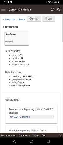

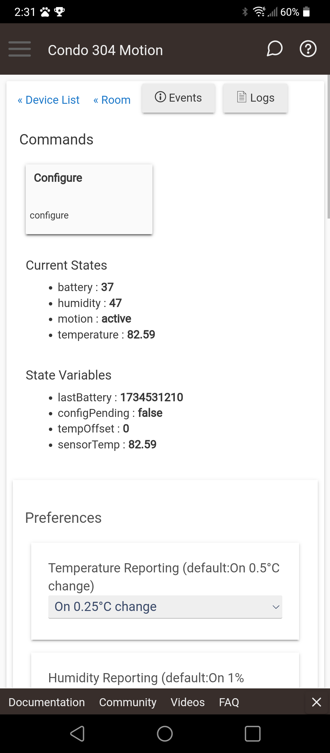

First issue battery percent not updated.

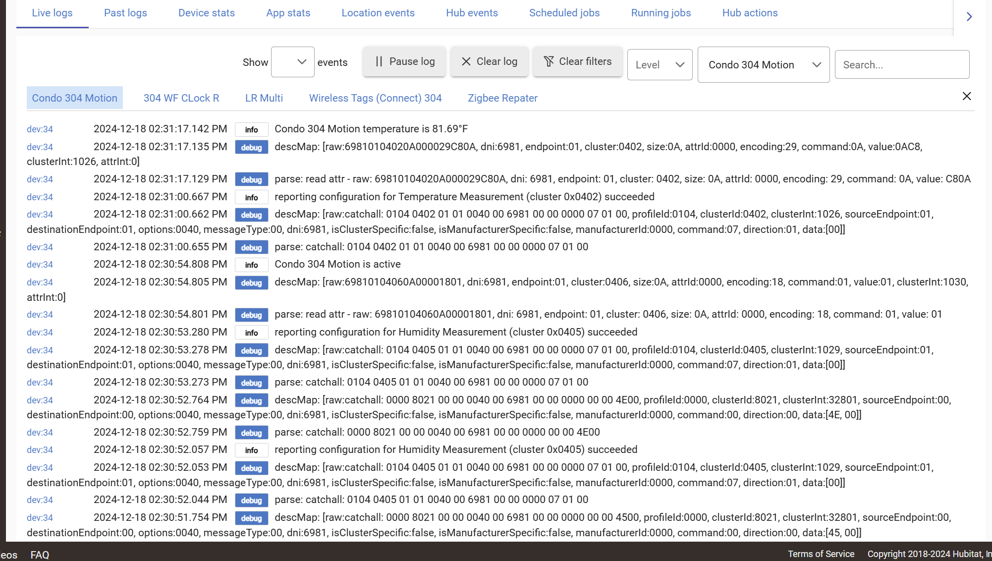

C7 never found it.even after hub reboot. Flashing lights indicated it was in pairing mode.
Had to reset the device to get it to pair in place.
Still battery percent not updated (37%)

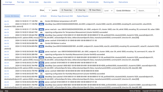

It is communicating see below..

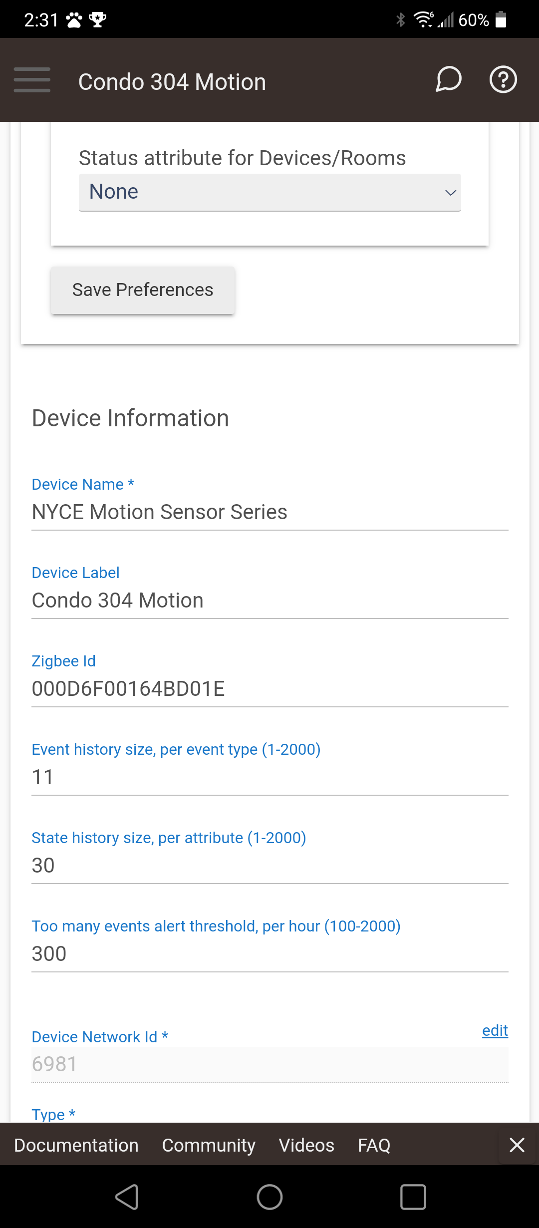

I am using built in driver..
