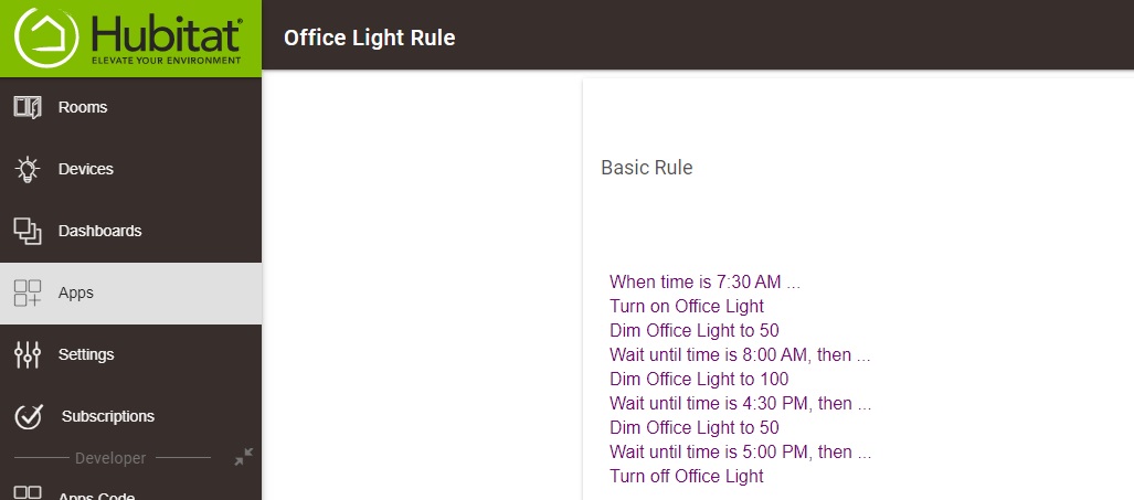

Please show the rule that did this. Screenshot.
Here's the rule that the failure happened on.
