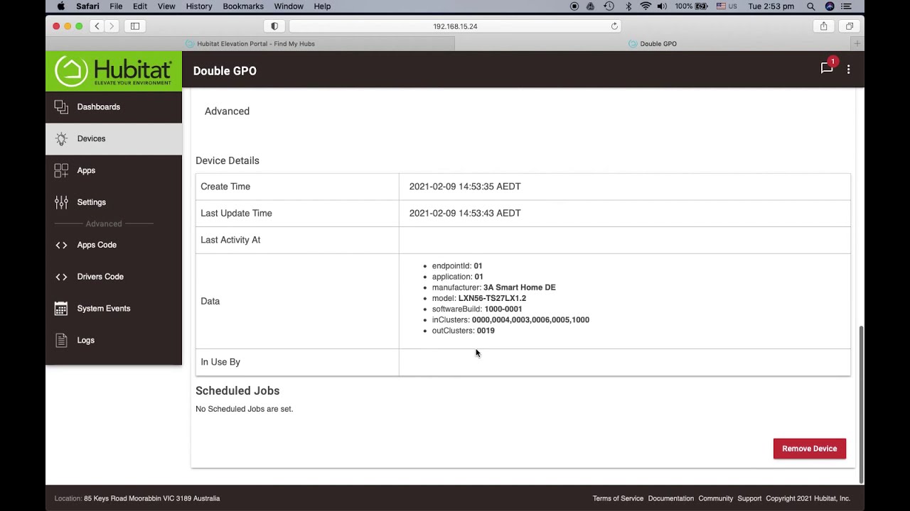

I am using NUE 4gang switch too.. Initially this was problem for me and I went back to the supplier. Issue been solved now and I was able to see more than half a dozen 4 Gang switches.
Please follow the instructions from the YouTube link :
Please change the default name of the switch to Nue ZigBee switch from the scroll menu. This will fix the problem .
