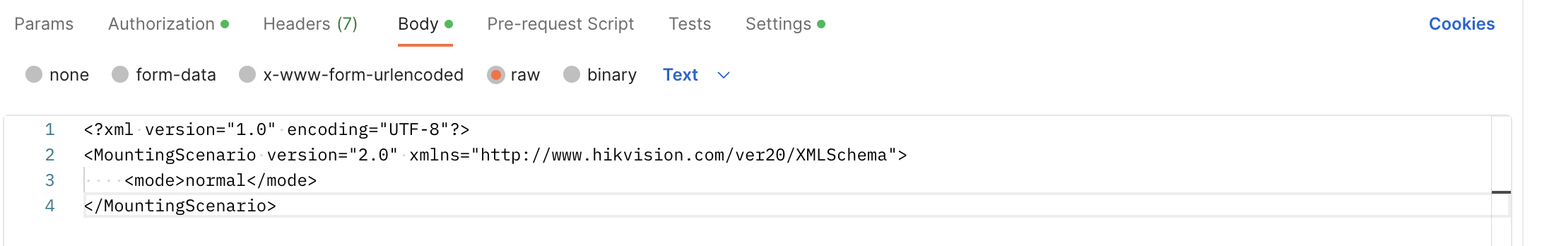

This is what goes in postman to change the scene in the camera to 'normal':

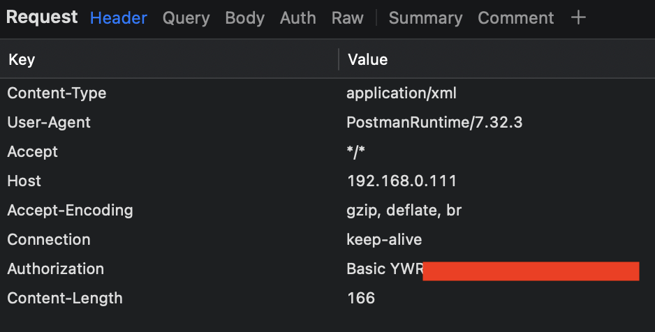

Since your last message I did manage to get some information from Proxyman but it's possibly just created another hurdle for sending this command outside of postman. I can see that the initial request gets a 401 unauthorised, then postman retries after amending the request and that works. If I "disable retrying the request" it will just fail. You can see this below:
It may be that I need to use https perhaps. Regardless I need to be able to test sending something in postman that works first time without the need for that app to rewrite the request based on the initial response.
In your Proxyman screen, can you select "Header"? It looks like you have selected "Raw", so I'm not what format the header is in.

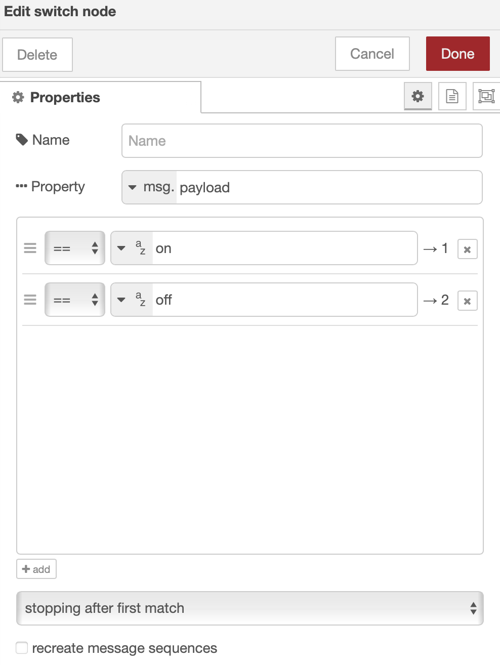

Finally got it working, probably about 24 hours since I first started messing around (talk about a wasted 53rd birthday!)
The switch node was incorrectly figured. I needed to use a debug node to find the correct path. Initially I was incorrectly looking at the property message.payload for ==on and ==off
What I needed to do was set it to message.payload.value ==on and ==off
Thats where I was going wrong. The output wasn't as expected
