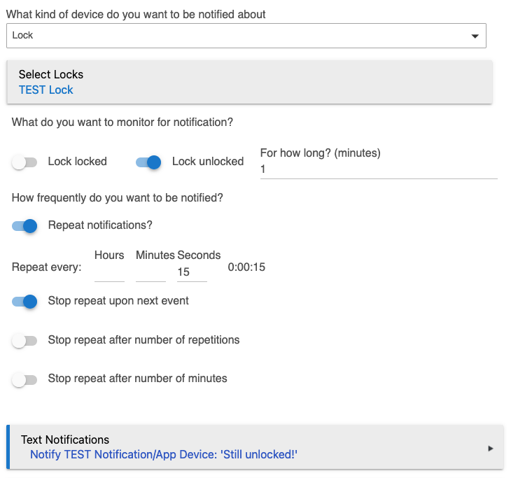

To test this, I used a virtual lock driver where I could manipulate the "lock" attribute into one of three states: locked, unlocked, or unknown. Further, despite being different from how most real devices would work, I wrote this driver so that I could generate two subsequent events in a row even if the device was already in that state (e.g., a "unlocked" event even if the "lock" attribute was already "unlocked"), though again most devices don't do this. Here was my app setup:
Expand to see Notifier app screenshot
My findings: any event for the attribute in question ("lock" in my example) will cause the repeat to stop, so the "stop repeating upon next event" option really does mean what it says (assuming you interpret it to mean the event in question and not any event for that device, like temperature on a motion sensor that also reports temperature if you're using motion here...it works as you'd reasonably expect). The app starts the timer when the "lock: unlocked" event is fired. It does cancel either this delay or the repeat on a "lock: locked" event (which I suppose you might call the "opposite," though for non-binary sensors there isn't always a clear winner on what this value would be), but "lock: unknown" does the same thing.
