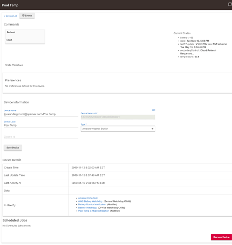

I have set up a notification on the standard HE App to send me notifications when the pool temp exceeds a certain temperature. Unfortunately, I have to turn off the solar panels manually still but I am working on an affordable solution for the future. For now, though, this will have to do.
Anyway, it used to work. Unfortunately, at some point, this stopped working. I am getting the following error.

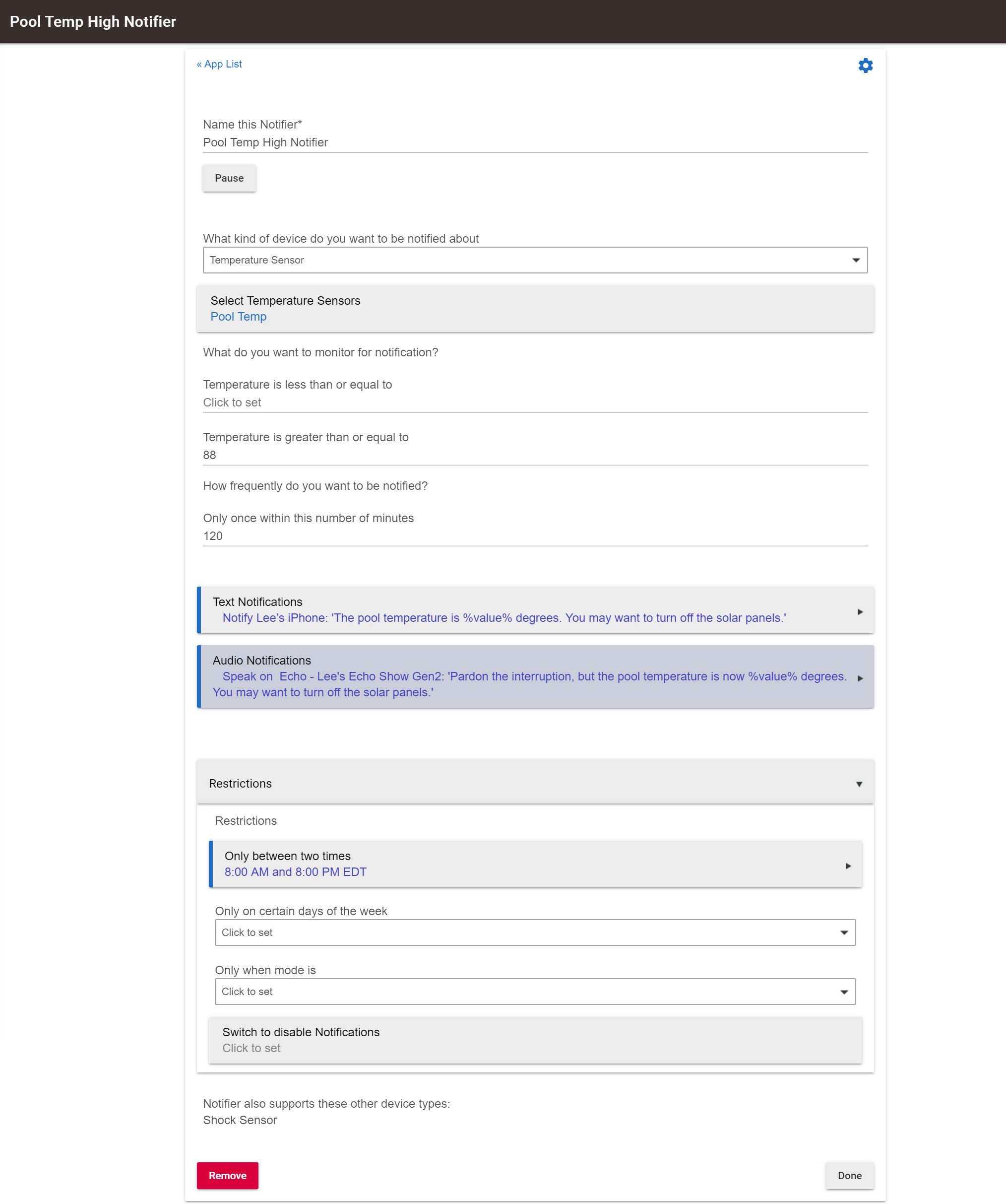

I don't know if this is the Notification app's issue or the device it is trying to access, but I want to start here. The rule in Notifications is as follows.
Not sure I have a good explanation for you as to why, but it might have something to do with 120 minute restriction (cron is a scheduling app that linux OSes use, and the hub's underlying OS is linux I think). Assuming the notification app's ID is 3297.
Have you tried deleting and recreating the notification?
thanks for the response. That is the ID of the notification shown. I have deleted it and rebuilt it with the same results.
I do understand cron. I guess i will try to delete the time restrictions to see what happens, but the fact that it used to work, and now doesn't seems more like a bug introduced at some point, or a corruption on my device.
Does any new notification that you create work when you try to put something into the "only once within this # of minutes" field? Or the "only between two times" restriction? With other devices, I mean.
Perhaps it's an issue with the parent notifier app, so that any child apps you create will all have the problem?
Interesting, I can reproduce this by creating a new notification and setting the field to 120 mins. When I set it to 2 mins at first, the notification worked fine.
It has something to do with that field being set to anything beyond 59 minutes. Any numbers I tried above 59 resulted in that error as soon as I clicked done, and the notification doesn't fire when the device status changes. If it's set to 59 minutes or less, the notification works fine, no error in the log.
Thanks. I suspected something like that but you took it to that level. Awesome. I guess my question is the same for Bobby though. 59 Seems like an artificially low limit for repeats. And I don't understand why it used to work an now it doesn't.
Presumably it's the one-hour (i.e. 60 minute) threshold that's causing a problem. I doubt it's intentional, possibly a bug that was introduced recently, as you suggested before.
I didn't bother looking in the logs at the time but that explains why I didn't see a notification for temperature device in my fridge. I had it set to once every 60 minutes. I deleted the 60 and it worked but I got notifications Everytime the temp changed. I'll set it to 45 minutes for now.
