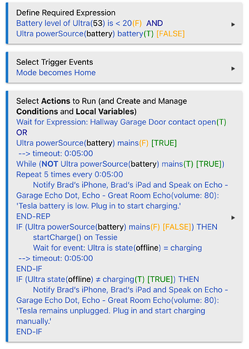

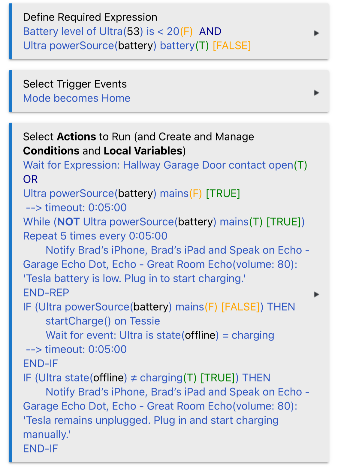

THIS IS my tesla reminder rule

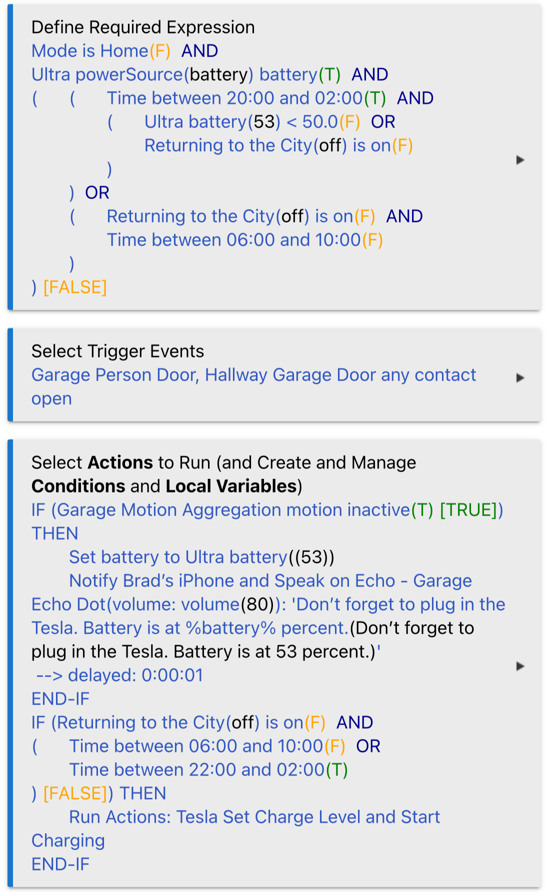

This is my reminder. I have it set this way with the garage person doors. So that when I take my dog outside in the evening, I get reminded when I walk into the garage.
I often arrive at the house after my drive from the City with a low battery, so this one reminds me to plug in when I open the garage door to go into the house. In case I forgot to plug it in. Also, automatically starts charging right away when I plug-in since the battery is so low

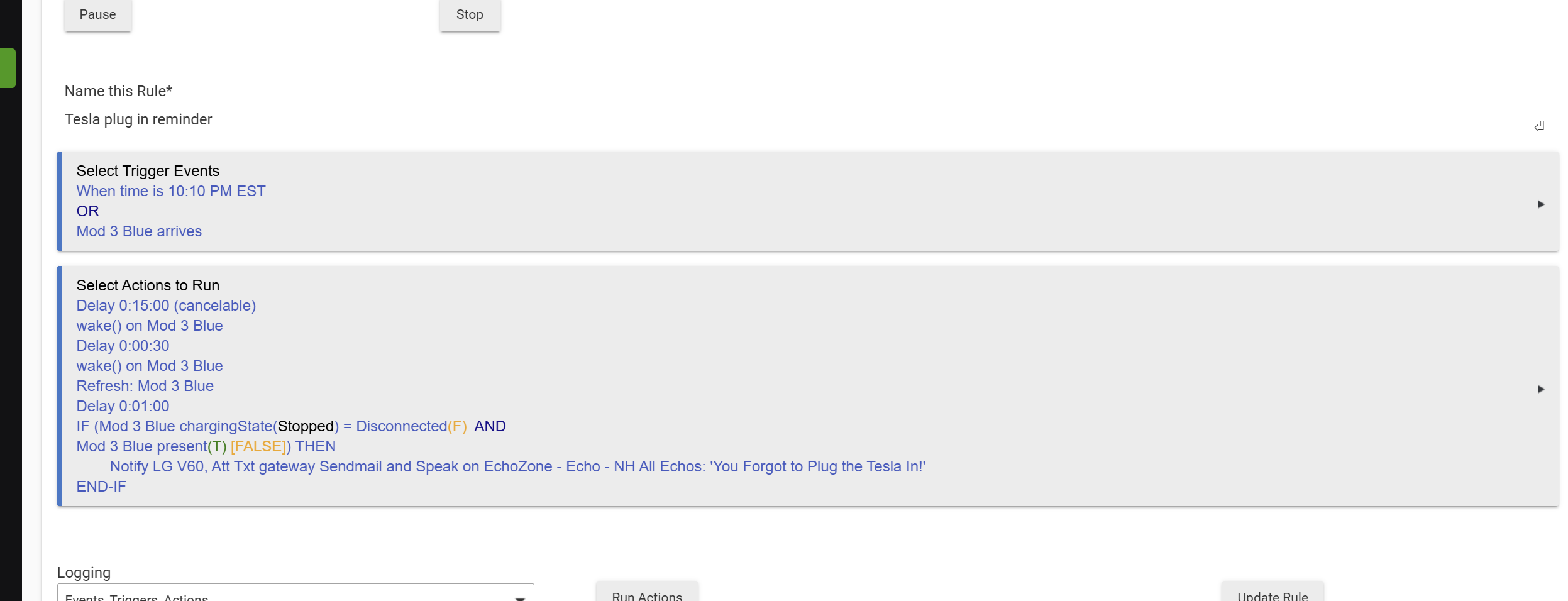

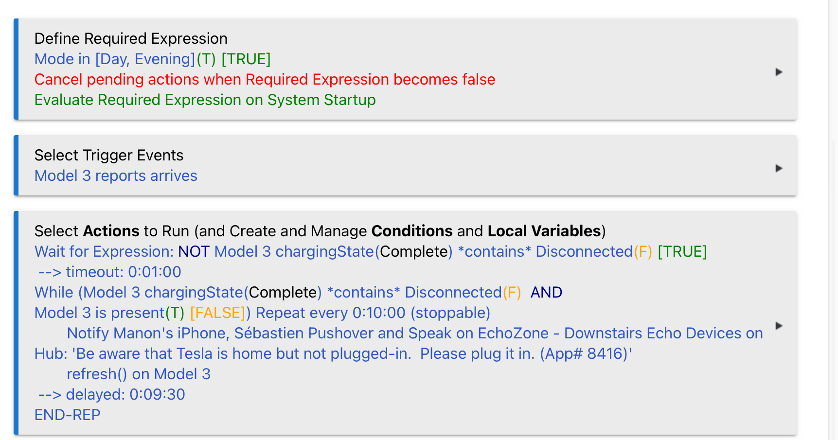

This is what I have. We keep our EV pluged-in 100% of the time:
