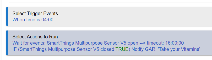

This is how I would do it no Booleans or virtual devices.
Wow! That is impressive!

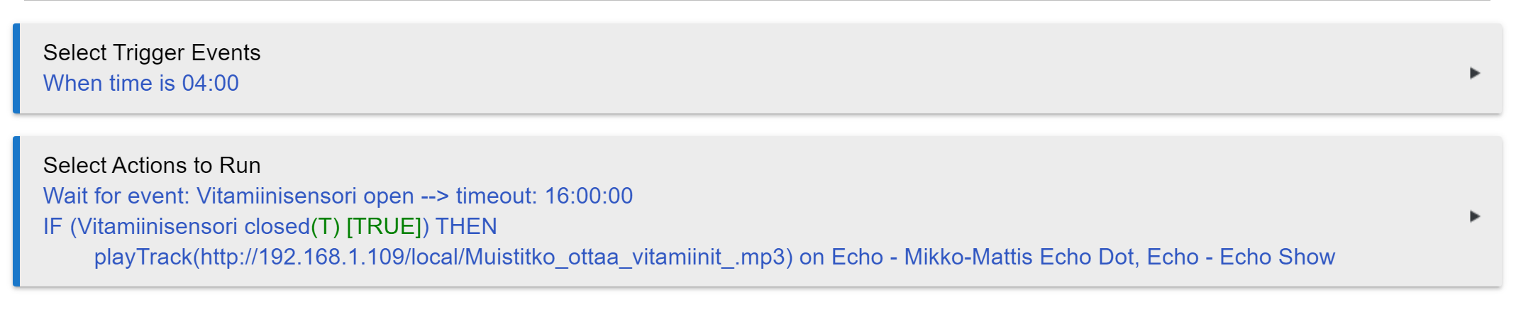

Can you please open up this a bit?
When sensor is or has been open, happens action "timeout: 16:00".
IF sensor stays closed, I'll get a notification?
That "timeout"-part is where I get lost.
The ā€œtimeoutā€ means that after a certain number of hours/minutes/seconds (16 hours in this case), it will timeout on the waiting - it will stop waiting and execute the next line.
So, essentially what this absolutely awesome code is doing is: At 4am, is starts monitoring your sensor. If you trigger it by opening the jar, it executes the next line where it will find that the jar is not closed and hence it will skip the associated action and the program ends until tomorrow at 4am. (No notification required today since you opened it.)
If 16 hours after 4am - at 8pm - the open even hasn’t been received, it will execute the next line and as long as you don’t open it just at that moment, it will send the notification.
Does that help?
Thank you for the clarification.
My god, that sounds absolutely brilliant!
I try to put together the code myself.
Could this work?
This is so out of my expertise that I'm not sure what I just did.
It looks good to me! I don’t think it’s necessary, but I would add an ā€œEndifā€ command at the last line.
If you want to test it, you can always set the timeout to something like 1 minute and manually execute the rule.
Like this?
I'm gonna test it tomorrow when holidays starts.
Thank you very much @Sebastien, @at9 and @bertabcd1234!
Yup!
