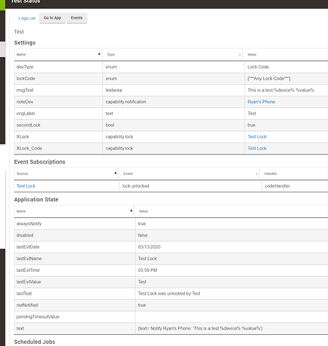

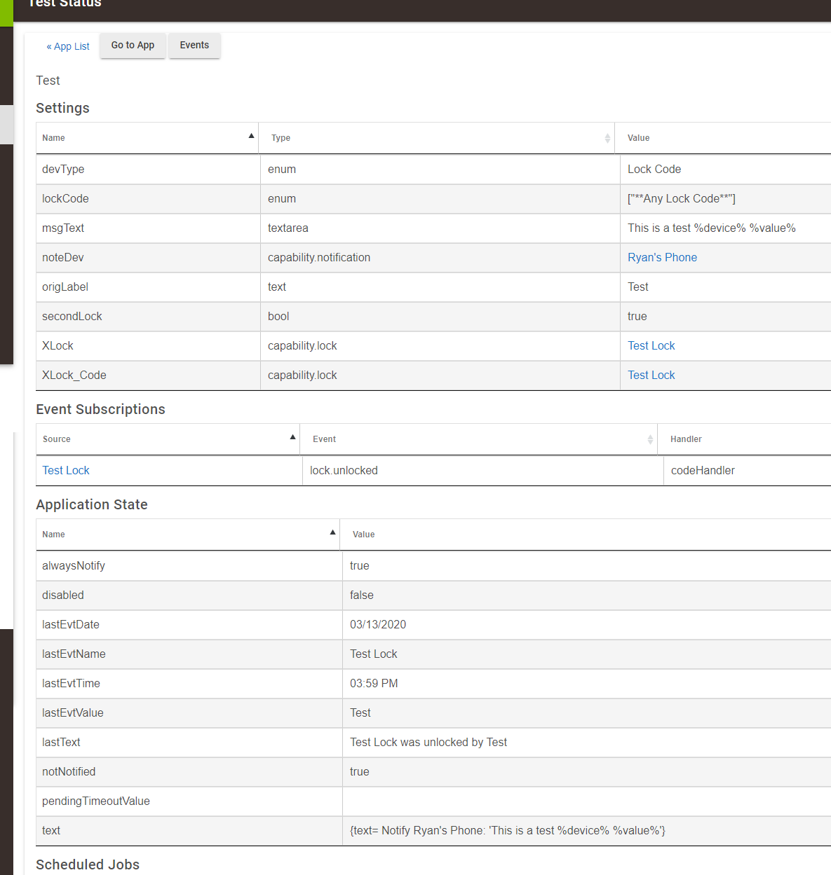

I am wondering about some of the nomenclature used in the app. Where you select the lock device it says "Select Lock Codes" but then below that there is a drop-down for lock codes also. The first selection should be "Select Lock Device". I wonder if this is just a labeling problem or if it is assigning the same variable twice?
@bravenel or @mike.maxwell or @chuck.schwer I think someone needs to take a look at the lock portion of Notifications. At a minimum, it looks like something is mislabeled (the lock device selection). Obviously I can't tell if there is something else that is going on.

@bravenel, I can confirm that using the "Any Lock Code" selection does not work as expected. I was unable to get notifications from the app until I selected each lock code individually. Selecting "Any Lock code" did not work correctly.
@Rabbithole If you select each of your lock codes individually, you should get notifications correctly. I was able to get it work with everything else the same in your app setup including your variables. Everything else is working correctly.
Yes, confirmed, and fixed...
ahhh there you go. "any lock code" does not work. when i selected every code individually, I got it to work again. Thank you so much
