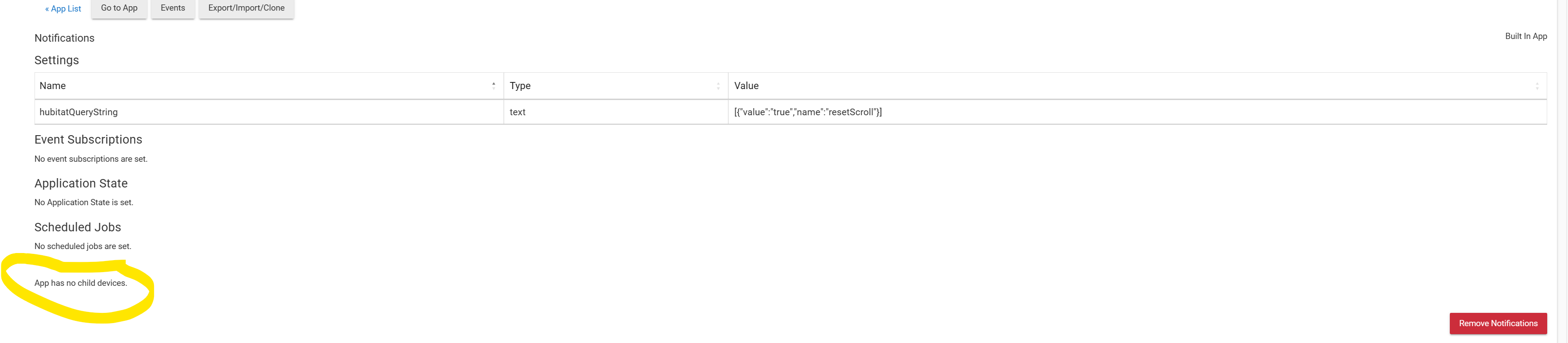

I "think" I should see the iPhone listed when I click the "gear" when I go into the app to create a notification, but it says, "App has no child devices" on the bottom of that page. I am new enough that I have no idea how to fix that...assuming it should list my iPhone there.
I'm guessing I did something yesterday while trying to set up Geofency....though this is not the phone/device associated with that app.
Since I'm so early in the setup process...coming over after years with Homeseer...I think I just create a new device in the app. Again...thanks!

Is what I have circled normal? A notifier I made previously works...new ones don't. Creating one seem pretty straight forward. New ones are not listed at the bottom of my iPhone device page. Only the one I made the other day.
What you've circled is normal--this app does not create any child devices (nor do most apps that are not intended to help with device integration, e.g., Hue or Kasa).

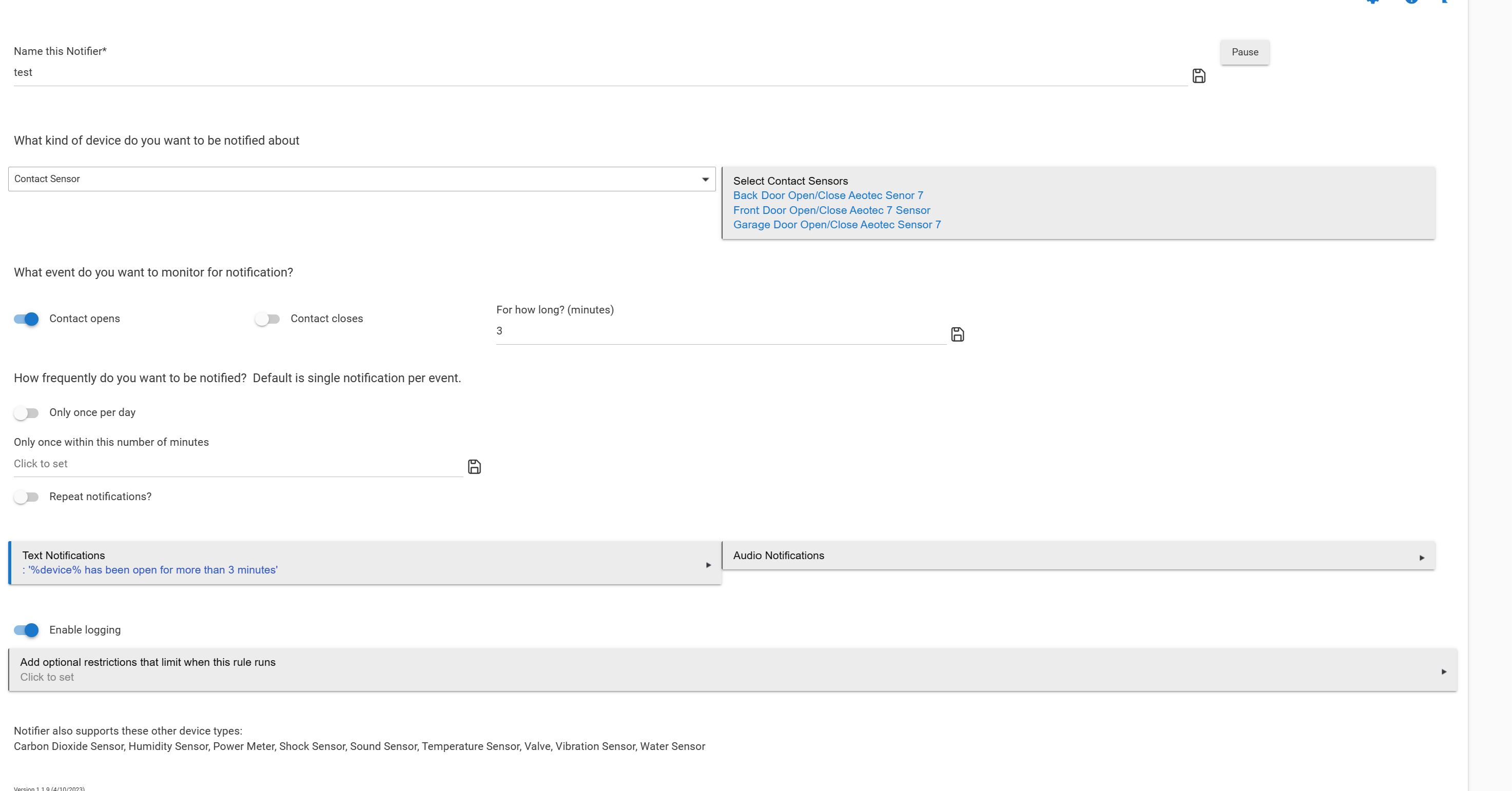

From your second screenshot, it appears you do not have a notification device selected to actually send the notification command to (there is normally a device name before the colon). This is in the Text Notifications box.
Ahh I see that now in the one I made before...but it's not an option I can set? If so, where do I do that?
THANKS! The one that shows on my phone app still shows and guessing that is why it's still working...but again, my first thought is I should just delete that one on the app...log out and start over.
You should be able to click/tap into the Text Notifications box and select it as a device there.

OK, thanks I saw that in other posts when notifications failed. I clearly need to step away from the keyboard for the rest of today. That's even in the help file. Thanks again. It works now. The worst part is I must have done it on the first rules. Sigh.
