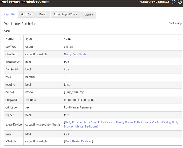

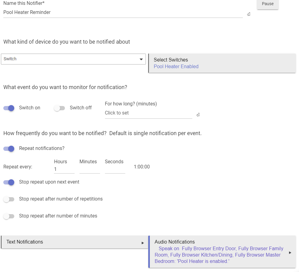

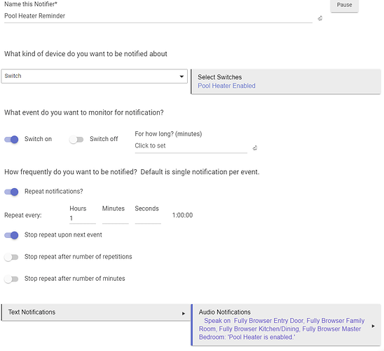

I also cannot get repeat notifications to work recently. This very notifier used to work, but I have upgraded to 2.3.8.140 and it appears to not work now.

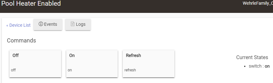

The Pool Heater Enabled switch is indeed on:

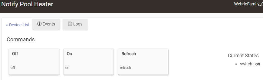

The Notify Pool Heater switch is also on:

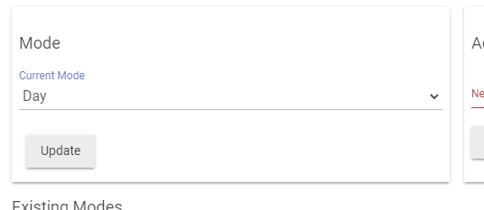

The current mode is Day:

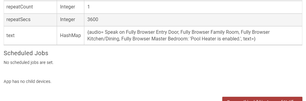

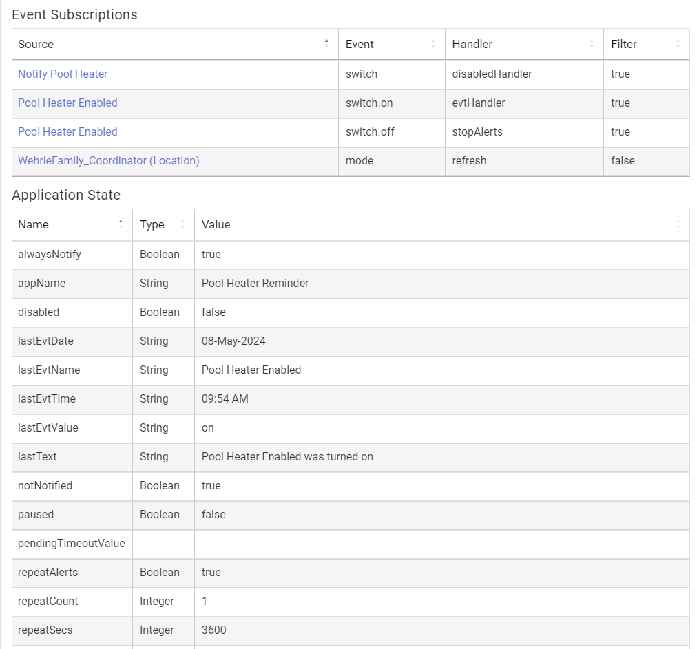

I would have expected to see a scheduled job for this notifier app, but I do not:
I can also hear other notifier apps speaking through those devices for other events.
Strange...
This is quite strange with no obvious explanation. One thing you could try, which may or may not resolve this, is to clone this Notifier (gear icon in upper right of Notifier app page to App Status page, then Export/Import/Clone. Once you have the clone, open it to confirm everything, and hit Done. Disable the original Notifier for now, while you test the new one.
Got this figured out.
I tried:
  1. Pausing and resuming the notifier app - Didn't solve.
  2. Cloning the notifier app to see if the cloned app worked - Didn't solve.

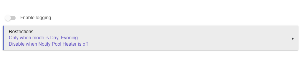

  3. Removed the Notify Pool Heater switch restriction that I added yesterday - Didn't solve.
  4. Cycled the triggering device (Pool Heater Enabled) off & on - SOLVED
My chain of events yesterday was that I added the switch restriction after the triggering device had already triggered the necessary state. (I was adding a feature to provide an override capability to the user interfaces.)
It seems when edits are made to a notifier app that is set for repeats, it deletes the repeat scheduled job and won't reschedule a job until the triggering device cycles again. For triggering devices that have long lifecycles for their states, this appears to stop the repeat functionality from working. You have to cycle the triggering device. This is not obvious. It may be useful to add some logic to the Done/Save of a repeating notifier app, to query the triggering device state and reschedule repeat jobs if the state warrants.
