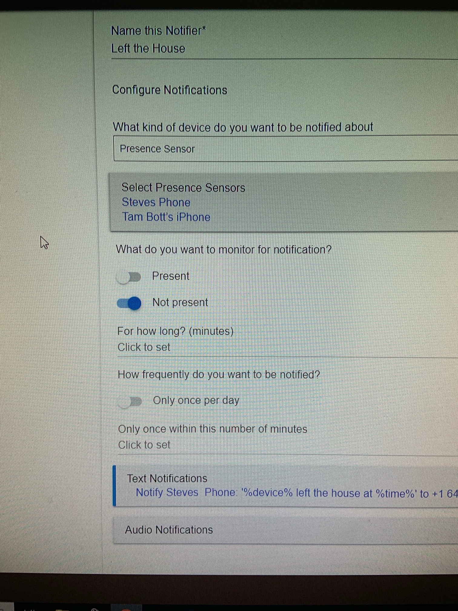

I have setup a test notification to fire when either iOS devices leave the geofence. The two options to start with are text notifications or audio notifications - is there no way to get an iOS push notification instead now that we have the iOS app. In the device listing itself in Hubitat you can send test notifications to the device - or do I need to activate this somehow ?

If ‘Steve’s phone’ has the mobile app installed, you wouldn’t need to enter the number for a notification. The phone number entry is for SMS.
So in text notifications, I just choose the device "send notification to device" choose the phone.
I dont need to add the custom message or the phone number then ?
Yes, you can add a custom message if you would like to. Entering a phone number will send it as an SMS text message instead of a push notification.
