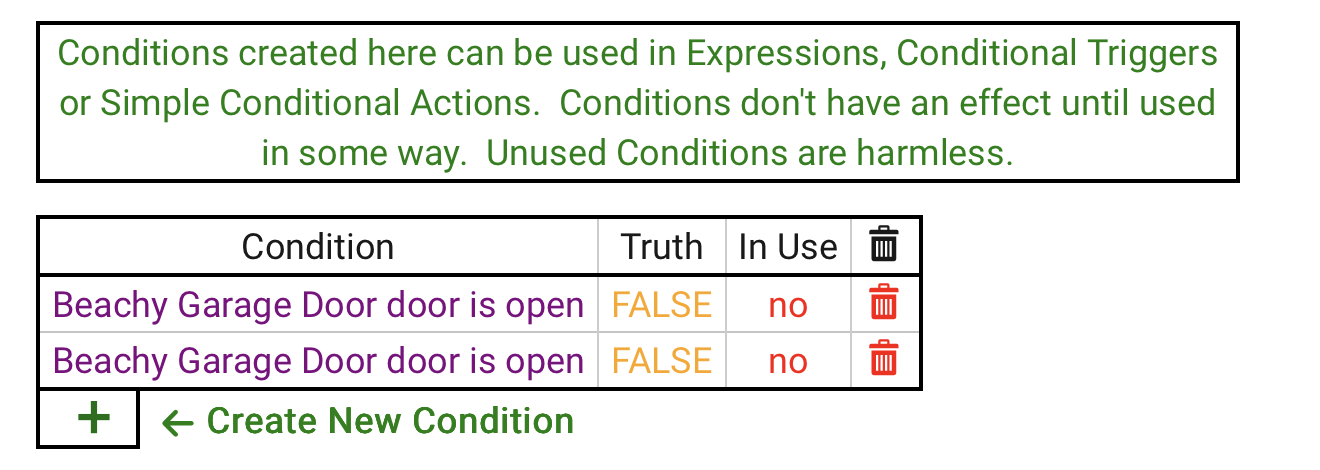

Interestingly, you can create two identical conditions in the create, edit or delete Conditions area.
