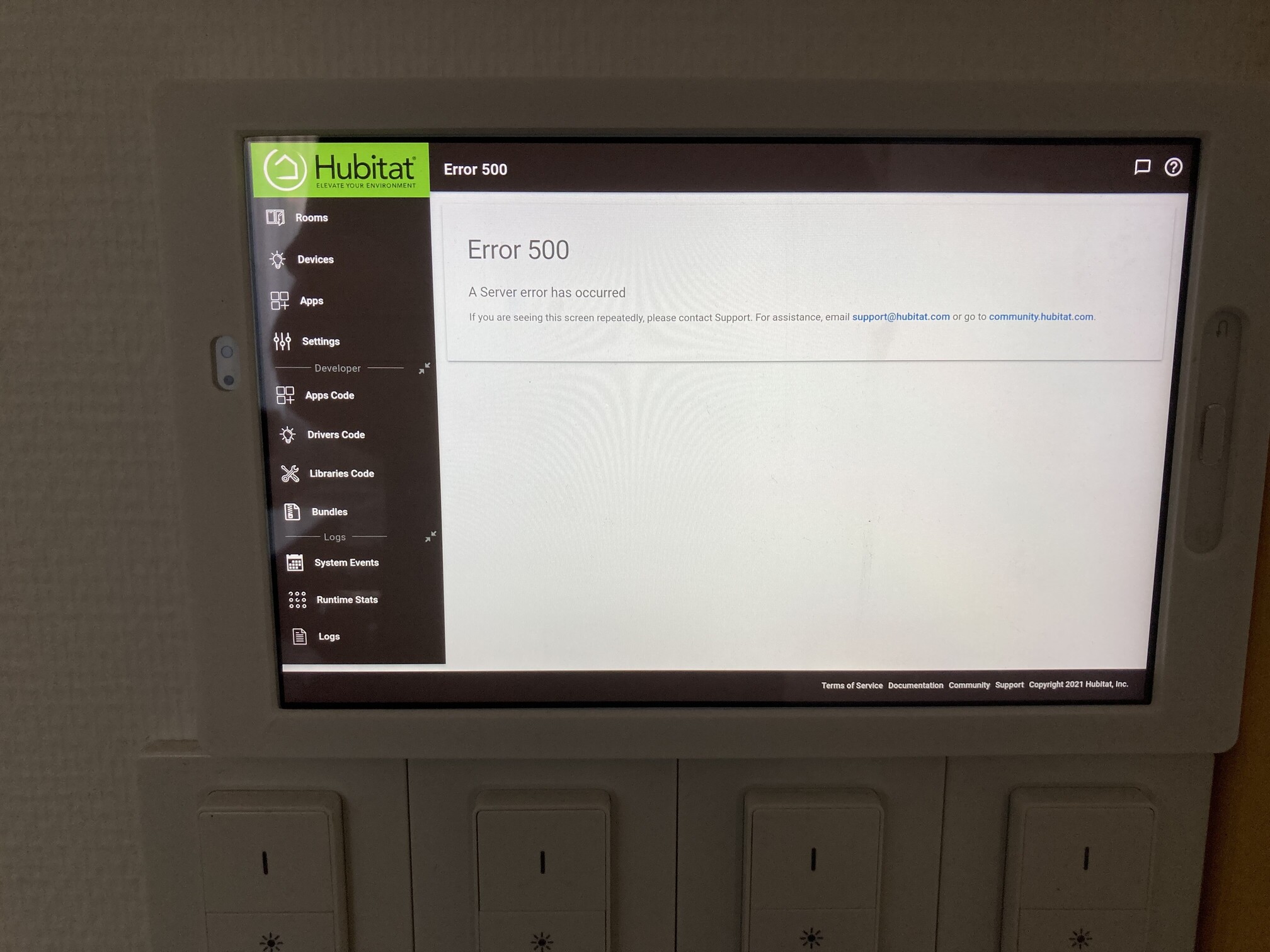

I'm doing nothing at the time the crash occurs, that is just it.

Was going to disable every app, but cannot restore from any database backup. Even my local backups on my pc result in a corrupted database message.
As a last resort I did a PTP for 20 minutes, but even that did not solve my issue.
So it seems I have an expensive brick / doorstopper atm.
Turned out that my hub had a strange hardware issue that was dropping some data.
