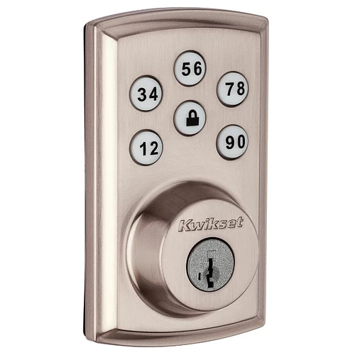

Howdy all. I have recently installed a Kwikset 888 on my back door. It is connected to my hub w/out any problems. HOWEVER, I believe there is a bug w/ this lock in that it keeps adding back a particular 6 digit user code. I've tried factory resetting, deleting the code manually, and deleting ALL codes. These seem to work until I enter my own user code and, voila, the same code mentioned above gets added back. I noticed this code initially upon installation in the code list in HE from the lock. Adding my own code and deleting the existing code only worked for about a minute and then it came back. After I added a master code and deleted all codes, it came back again after I input my code, but this time it doesn't show up in the code list. Still opens the lock, though.
I contacted Kwikset and they sent me a brand new 888 and this one does the exact same thing! I'll bet that I can open any Kwikset 888 with this code. I've reported this recent result to Kwikset but haven't received an answer. If anyone is willing to test this on their 888, pls PM me and I'll give you the code. I don't want it floating around in the open for obvious safety reasons.

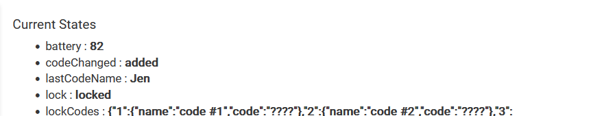

At least in schlage's case it's really not. To see the permanent codes (2 of them) you have to pull the inner lock panel (actually unscrew the deadbolt) to get a look at the labels. So unlikely to happen. And they don't show in hubitat. As you can see in the pic even unencrypted, slots one and 2 only have ???? in it as the code.
