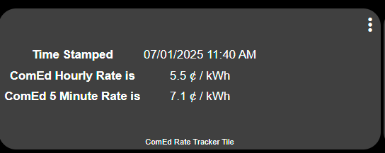

I have created a custom driver and Dashboard Tile to poll the ComEd Website and get the Hourly and 5-minute rates. I use these values to create rules to turn off appliances and adjust my thermostat settings—this way, when the rate is $1.63 per kilowatt, you're not running your air conditioning.

Have you by chance figured out the definition (even just conceptually) of the two primary attributes--hourly rate and five minute rate. Not sure what they mean?
