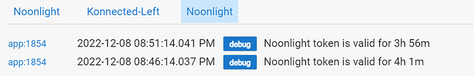

I've had Noonlight up and running on my Hubitat for years triggered through my Konnected.io boards with zero issues. Today my smoke alarm went off in my guest bedroom and I never received a call from Noonlight as expected.
I reached out to them and they said the last alarm trigger they received was November 2021. I went in and checked my apps & drivers, they are still the original ones @nate put up 4 years ago, but copy/pasted over again just in case. Then went into Noonlight and triggered the siren. I get the following error.
Any help would be appreciated, thank God that the smoke alarm was a false alarm and not a real fire.

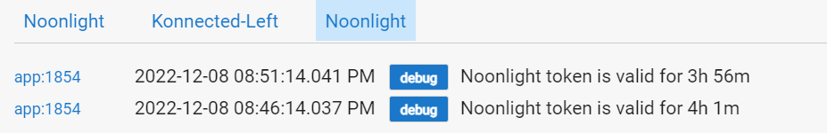

My Noonlight token is valid as well.
Thanks in advance for the help!

Yes sorry, I will tag it as solved. I had up update my O-Auth key in the Konnected app and it started working again immediately.
