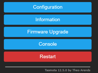

When you plug in the Athom plug, Tasmota on the plug creates a wifi access point (just like a router) with a SSID/wifi network name of Tasmota-###### (no password) with an IP address of 192.168.4.1 so you would need to use a phone, tablet or pc with a wifi adapter to connect to the Tasmota plug. I personally use a desktop pc with a USB wifi adapter that I can connect as needed while still retaining access to my LAN via the wired port.
Once you are connected to the plug (Tasmota main menu below) you can connect it to your main wifi network.
  1. Click on "Information" and record your plug's "MAC Address", then click on "Main Menu". Then access your WiFi router and setup a DCHP reservation for this plug. Using the plug's MAC address.

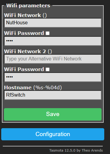

  1. Next, click on "Configuration", then "Configure WiFi". You should see the menu below. Type in your WiFi networks SSID/Name and password. Click "Save",
  1. At this point the plug should 'reboot' and attempt to connect to your WiFI network. Wait about 1 minute. If successful you should be able to browse to the IP address you chose for it in your DCHP reservation. Note: you will need to switch back to your main WiFi if using a phone/tablet from the second paragraph above.

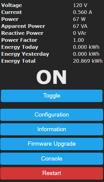

If all goes well you should see the main Tasmota menu with power monitor stats as shown below: Ignore the big 'ON' and the 'Toggle' button. My plug has a relay.
If you have a load connected to the plug you should also start seeing power consumption stats like mine shows.

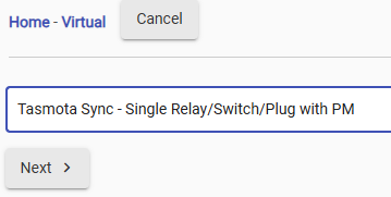

  1. Next you need to install Tasmota Sync Drivers on your hub. Specifically #5 1. Single Relay\Switch\Plug with optional power monitoring.
  2. Once you have the driver installed on your hub, create a new 'Virtual' device and select the driver you just installed give a name, room, then when finished, click View" device.
