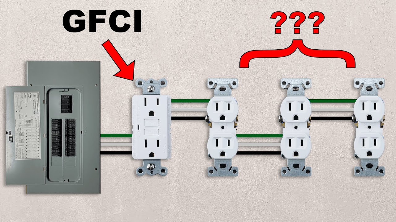

Is there anything different to wiring a GFCI outlet? I'm considering swapping out a stock GGCI outlet with one that has a USB port so I can potentially add an Aqara camera and presence sensor. I think I can handle a straight swap for a regular outlet, is the GFCI different or more difficult?
This! I was installing one at a friends house last weekend and mixed them up and wasted time trying to figure out why the outlet wasn’t working. Was a brand new outlet at his dock and I wasn’t thinking when I loaded the wires into the bottom terminals out of habit and the top needed the line and bottom is for load.
Great idea. This was a new outlet I added at the entrance of my buddys dock. So no existing wiring and I just terminated the wires to the bottom terminals out of habit where this particular brand of GFI wanted line to the top terminals.
Good call -- I was going to warn about this same thing too... Different manufacturers flip those locations, so you have to be careful when swapping a replacement (ask me how I know lol)
