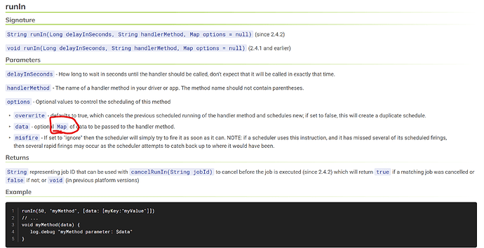

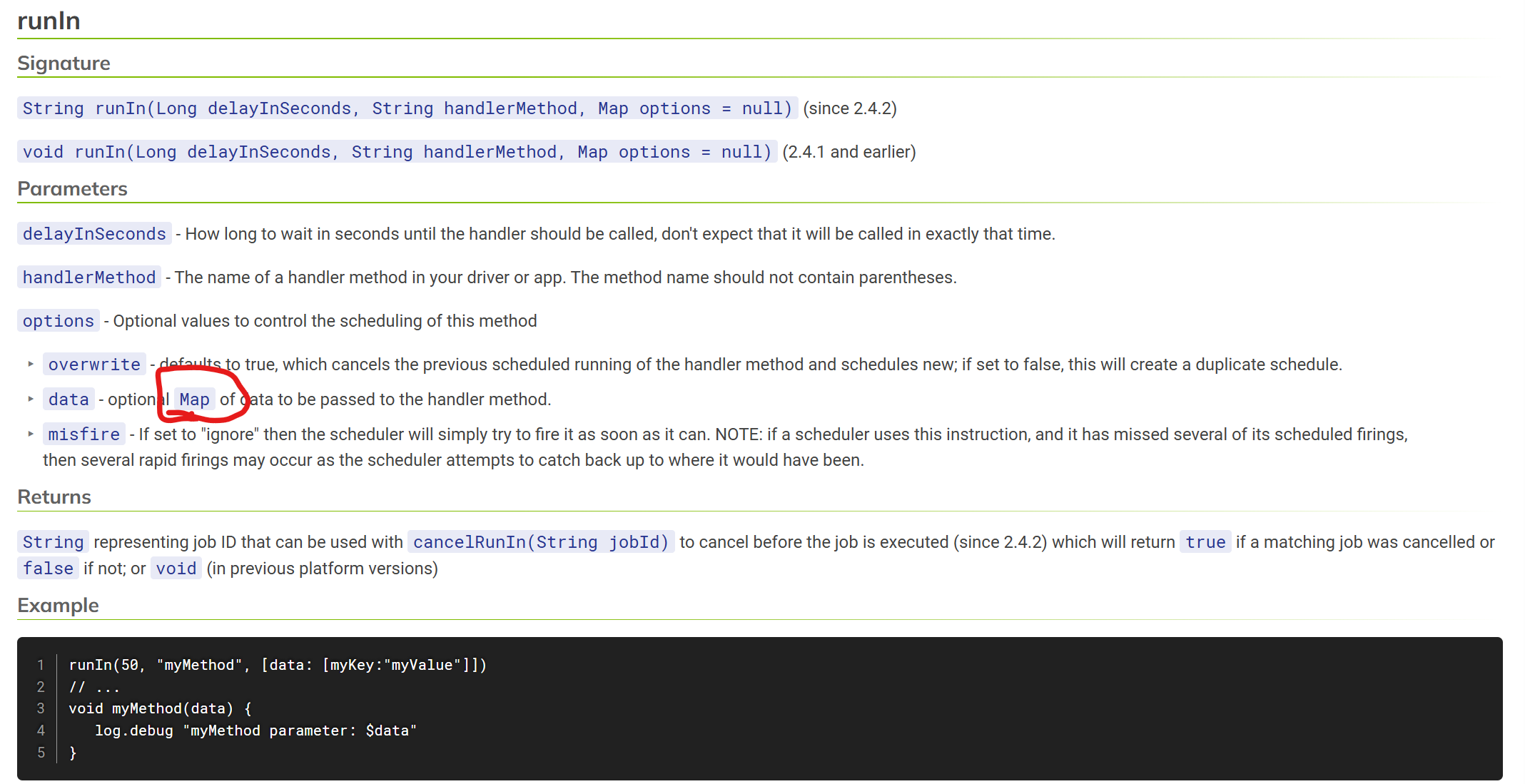

The documentation explains this fairly well, IMHO.
You need to pass a MAP of the data you want passed to the Method.
