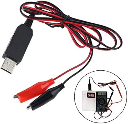

I've converted an Iris v2 motion sensor to usb and plan to do some contact sensors using these step-down whips.

I 3d printed a cr2 battery sized case that I then mounted a 3.3v regulator and female microusb breakout inside of along with nickel strips at ends of "Battery" for contacts. Allows me to use either a real cr2 battery or substitute my battery eliminator with usb wall wart and micro usb cable. Microusb on left and 3.3v regulator on right. I also used a 3d printed CR2 battery case combined with conventional 2xAA, C or D cell battery holders for spots where mains power wasn't convenient but I wanted better battery longevity.
Doesn't look great but does the job.
