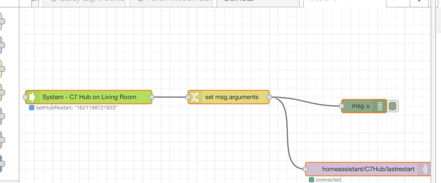

I’m trying to push some of my hub stats to homeassistant via MQTT.
I can pull in the value from hubitat but I can’t push it to the mqtt broker… where am I going wrong with this simple flow?
I don’t see anything being output to the debug node ..
  1. You need the value you want to send to MQTT to be in msg.payload. Looks like you may be putting it in msg.arguments?

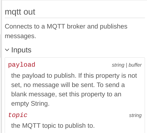

And even though people say I'm too preachy about this, please make sure you read the online help for the nodes you use. It almost always explicitly defines what valid input, and expected outputs are.
For the "mqtt out" node it specifically says it is expecting msg.payload for the value to write out:

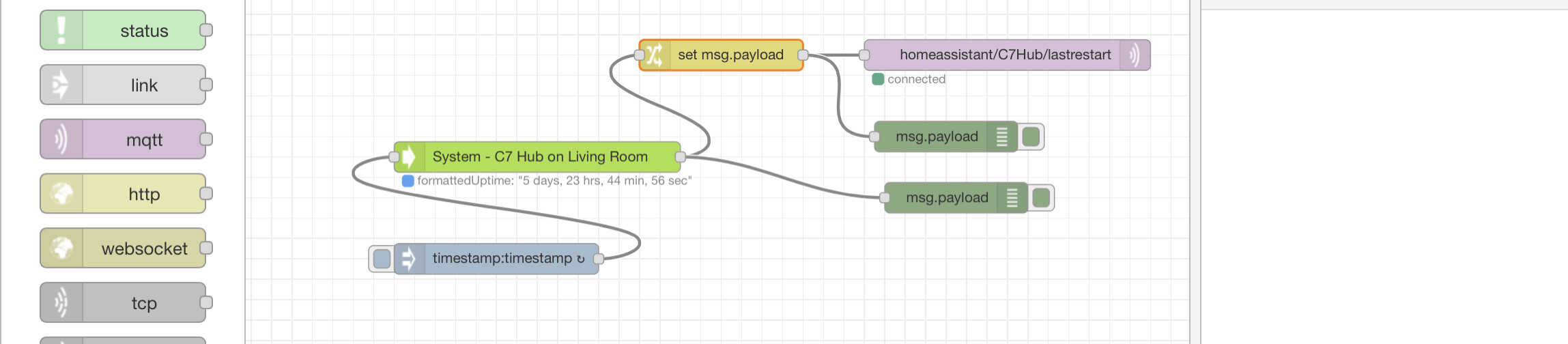

I’ve got a timestamp inject and a change node that sets msg.payload to msg.payload.value as suggested
I never see anything on the debug nodes when I inject the timestamp manually or wait for its elapsed time.. the timestamp node is however outputting a timestamp..
:thinking:

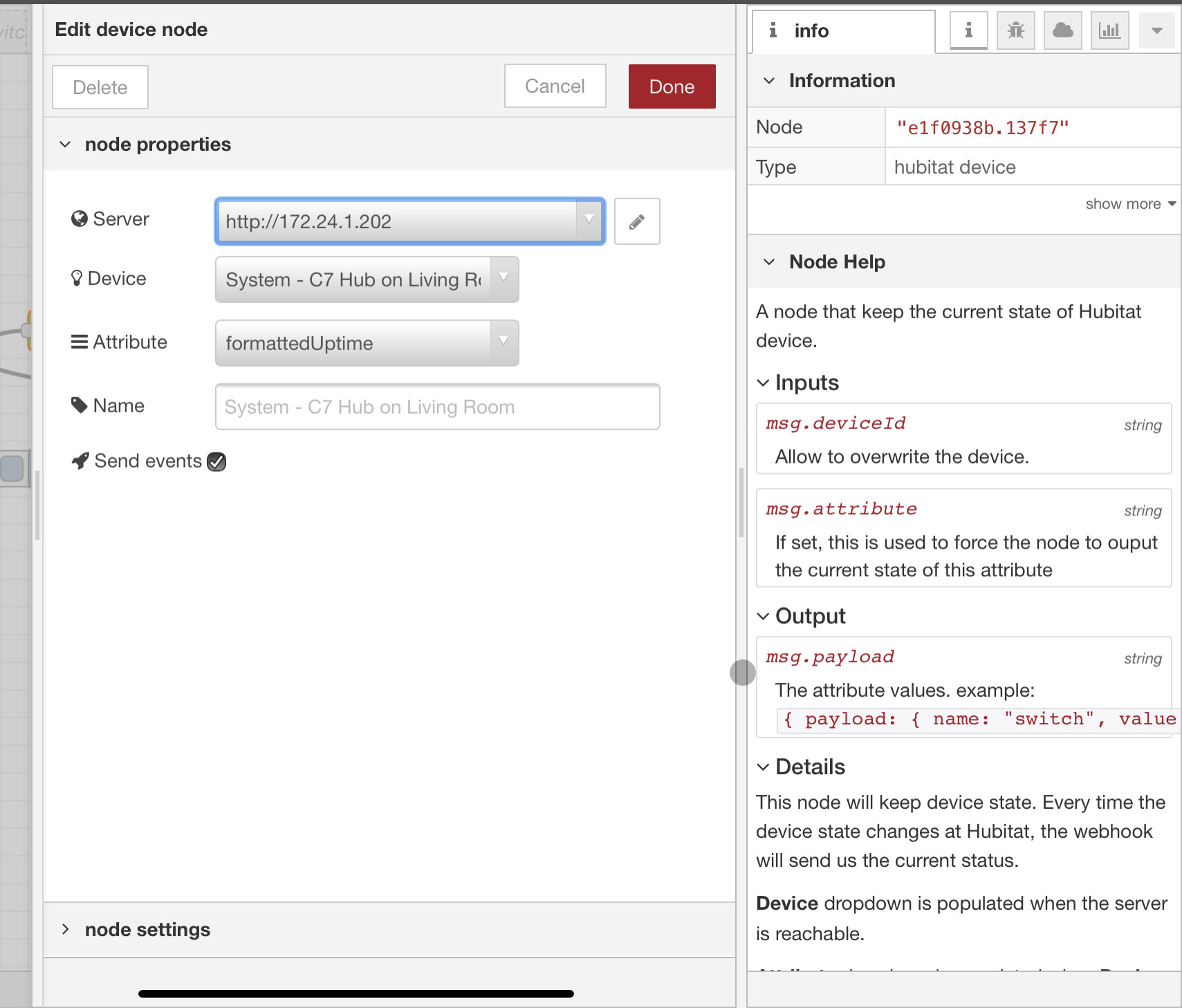

What kind of node is that 2nd one, the light green one? I thought originally it was a hubitat device node, and my original advice was based on that, but I just noticed it is a different icon I don't recognize.
So while the advice on msg.payload going into the mqtt out node still applies, I have no idea how whatever that 2nd node is works, or whether an inject going into it would make it send a payload.
Sorry about that.
It’s a “hubitat device” node.. could I be using some spurious integration ?
Weird. That is definitely not the default icon for a hubitat device node. Now, icons can be customized, so maybe you did/it was?
Also, what version of node-red, and the hubitat nodes are you using?

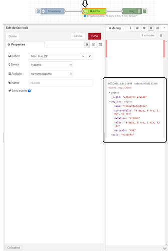

Standard hubitat device node looks like this (notice the icon):
In any case, if nothing is outputting from the device node when you inject into the input, then something is wrong. Maybe that formatted output field is crashing it/making it error out or something. I've never seen/tried an attribute formatted like that one is.
Also, your node details page looks different than any I remember seeing before (unless it is a really old node-red version and I forgot) too... Current/standard installs of node-red don't have collapsible "node properties" and "node settings" headers.
So there is a lot going on here that is different than I would expect.

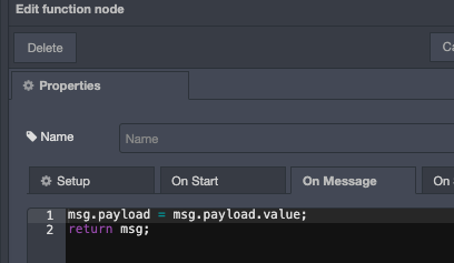

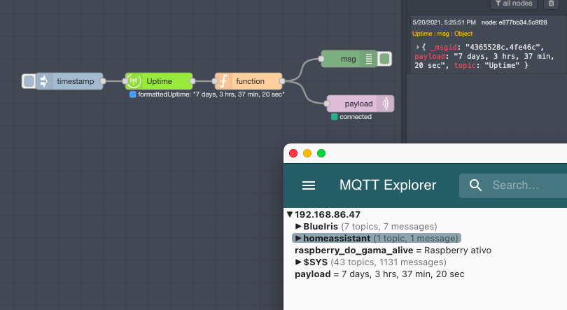

Instead of using a change node try using a function node.
Screen Shot 2021-05-20 at 5.29.54 PM
And then everything should work.
Nothing wrong with that, but that function node does the exact same thing as the change node.
And he said there are no messages coming out of his device node, so I don't think changing to a function node will fix it. He needs to get his device node sending out messages first. :man_shrugging:
Yep, you're right, the device node doesn't look right.

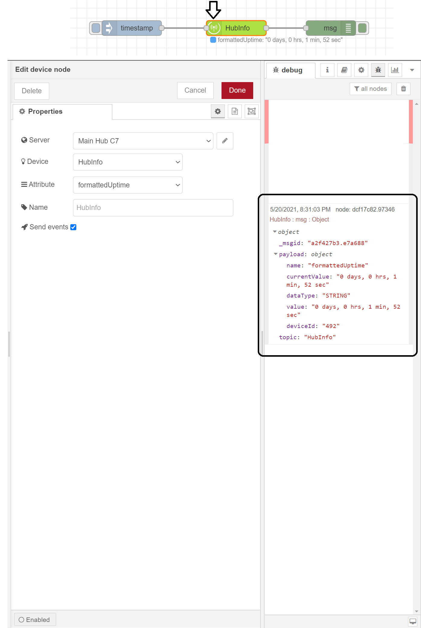

Yeah maybe add an inject node before the "device" node that should force things as a test.. but I agree with @JasonJoel something is weird with your HE palette... make sure it is updated.
Also make sure you are receiving events in general.. maybe your webhook is misconfigured in the Server Configuration.

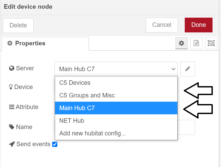

You can connect your C-7 to Node-RED as well - one less level of indirection. You can also add multiple maker instances on the same hub too. Lots of possibilities.
Here is my Node-RED HE Server config list.. Note: the "NET Hub" used to be my C-4 but it died and I transferred stuff over to my C-5 temporarily but kept the same config, just changed the settings. This screencap currently shows 2 hubs talking to Node-RED... a C-7 & C-5. C-5 has multiple instances (3) of Maker API and therefore multiple NR configs. Basically a legacy from migration and other stuff.
