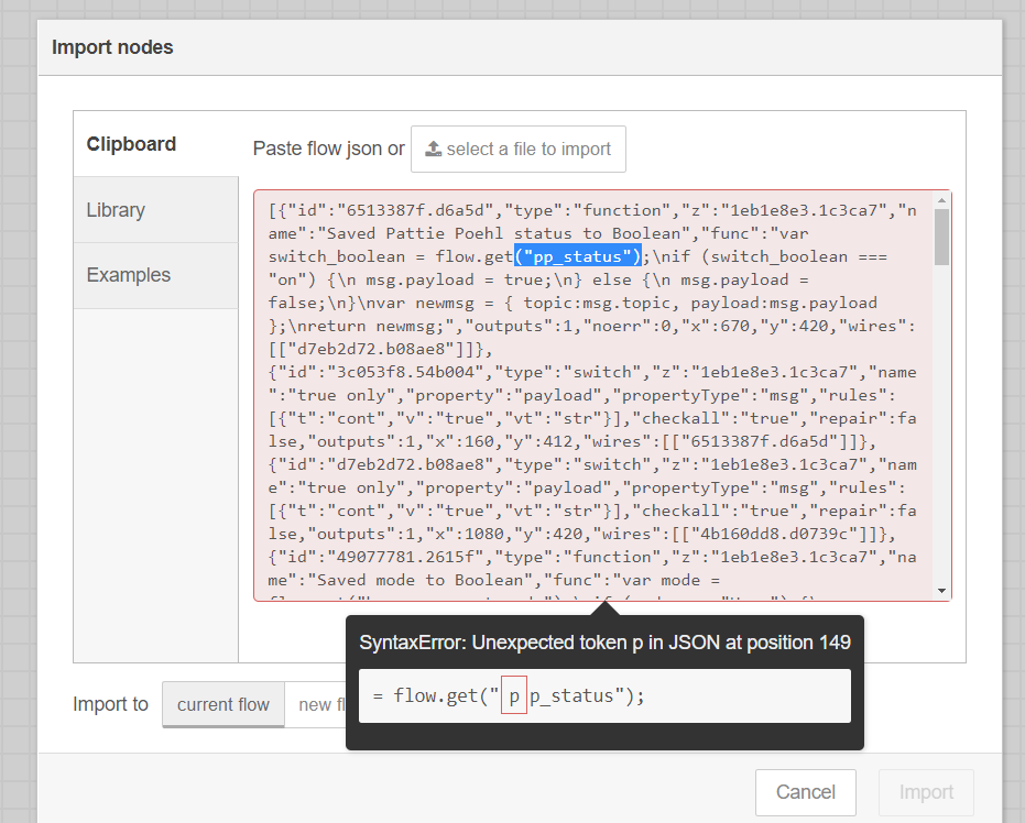

I cant import them. It has an error. Are you able to format the flow as text?
Here you go

P.S. Sorry about the other one not importing. It imported okay into my Node-RED. No, I made an error when I pasted the original. Fixed it. They should both be importable now.
Thanks, that worked. I'll look at it later, as busy/life.
