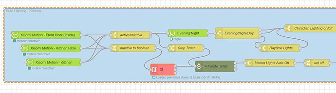

Side note on the other topic - Ultimate Boolean persistence won't work on any node-red being run in a container as they store the persistence file in the users root folder which is not persistent in (most) docker installs. I put in a feature request to them to put it in the node-red userDir (like @putch smartly did. :+1: ).

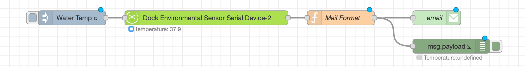

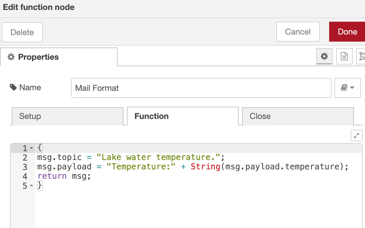

I have a temperature probe that measures the lake water temperature. I am moving off webcore and am struggling to get my automation to work in Node-Red. I want to have the temperature read every morning at 7:30 and the reading sent to me in an email with the message "the lake water temperature is XX". I can't get the email formatted due to my lack of Javascript skills... here is the flow:
this is how I have the mail format (copied):![Screen Shot 2020-10-26 at 7.16.58 PM|690x432]
(upload://A9lnzLx7Chu1KcrlsHgGI7szdfM.png) and this is the way the email comes out: ![Screen Shot 2020-10-26 at 7.17.19 PM|552x192] (upload://7VOCwN55lZrILHdl2E2jp35LtjR.png) and here is the message format.![Screen Shot 2020-10-26 at 7.24.12 PM|612x434].(upload://ggNUxD0WoixHr6flQztJ4UiaoPW.png) Any guidance would be appreciated.
Screen Shot 2020-10-26 at 7.17.19 PM Screen Shot 2020-10-26 at 7.24.12 PM
