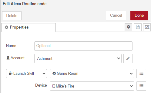

In fact there might be a way once all bugs are worked out to trigger Alexa to start listening. Here is how:
  1. build a skill (I did this using voiceflow) with the first action being a choice block (choice blocks are basically Alexa listen for the response)
  2. use the Alexa routine node from node-red-contrib-alexa-remote2 to start the skill
    In this example it is launching the Game Room skill on the tablet named Mike's Fire.
When I did this the first time, I got an Alexa bing and then she listens for my input and processed it according to the skill.
Of course just to be thorough, I thought would also try on my echo. When I did that it basically responded as if I had said Alexa but nothing more. Thus I could give any Alexa command including "open game room testing" or "what time is it" and then she would run the skill. Going back to the tablet as my target, it started acting like the echo and not the way it worked at first.
So I guess either the Alexa routine node has a bug related to launching a skill leading it to work only occasionally or Amazon doesn't want to allow this and blocks it after the first try, or I was hallucinating the 1 time it worked.
The node still seems to work for things like speak or launch routine, but not launch skill.
