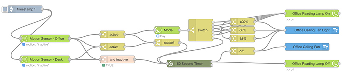

I dont think that will work for my use case. I have a four motion sensors in my office. All four report active when I walk in, but once I sit down, usually three of them report inactive, after differing time periods. After 2 minutes of no messages, the trigger node above would report false, which is what I am specifically trying to avoid. The fourth motion sensor in my office is still active; it doesnt continually resend active, it just doesnt send an inactive until there is no motion. For the problem I was trying to get around, I dont think it would work.

Can you use a 'AND' bool gate node, then feed that into a timer?
True will go to timer and False output will restart timer??

Yes, that's exactly what I ended up doing yesterday. Works well!
thats exactly what i do. I also only turn on motion with one of the motion sensors since the one on my desk points towards the door that opens into a hallway.

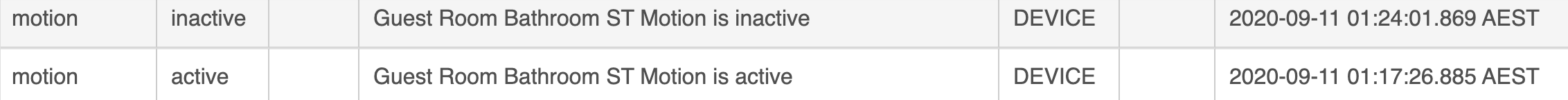

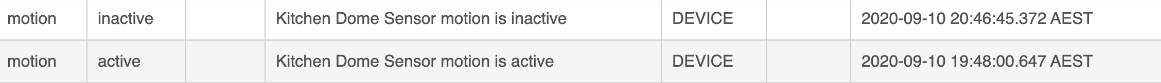

Well, there are many types that do NOT send new messages as long as motion remains active. I have a few myself.
For the other sensors, I completely agree that using the trigger node alone is a cool way to do it! I strongly prefer sensors that do the periodic reset/re-transmit, but not all of them do that.
Believe us, not all sensors re-send active events while they still sense motion. As a matter of fact, I don't think any of my sensors do that. I have Aeotec, Dome, Iris, Hue, and SmartThings sensors.

I think you might be mixing up what "re-trigger" means, or maybe the term is used differently by different devices/drivers. I can (and do) modify the re-trigger times on many of my sensors. Most of them are set to 30s, but if motion is detected within that 30s window, it's extended by another 30s before it will report inactive. Here are some event logs from 4 of my sensors (Aeotec MS6, Iris v2, SmartThings and Dome). You can see that they only ever report a single "active" event, and then a single "inactive" event, even though each of these examples shows more than 30s of activity.

I'm not sure what you mean about using them as presence sensors. All of mine work perfectly as motion sensors, but I was just pointing out that none of mine would work with the flow example you provided. Hence why many of us have to do something different.
