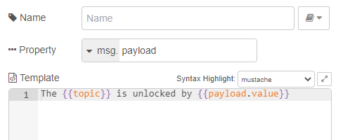

As someone who staunchly avoids using a Function Node whenever possible, I would probably use a Template Node in your case. This is mine that says what contact sensor has been open for more than 5 minutes:
Your line 1 would be: Garage Door is unlocked by {{payload.value}}.
Then, under Property, you would send on the message under whatever you want. It could be msg.payload or anything else. It's Msg.text in my example.

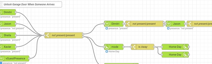

I finally had some time to play with this tonight, got node-red and Hubitat contrives updated and got stuck. How would I, for instance, capture presence states of a number of people (a, b, and c) and do a switch to do things like - if a leaves and b and c are already gone, set HSM and mode to Away. If either a, b or c enter, turn off HSM and set mode to Home. Would I use the change element to capture state of a, b and c on initialization? How would I handle the logic of if either a, b or c; arrive do x or if everyone leaves do y. I have this in rule machine today but I’m struggling to grasp how to translate it into node-red. Any pointers/examples would be appreciated.

A ?simple? way to do this (taken from a much earlier post in this thread apologies to the original author for my laziness) is to assign a numeric value to each presence state either -1 for "left" and 1 for "arrived" and keep a running total in a global variable. something like this:
The above is hastily thrown together but hopefully you get the idea. The gray nodes are just NOOP nodes.. for display purposes only.
Also you would need to initialize your global to 3 as a ground state when everyone is home (or use 0 and adjust tests accordingly) and probably should enable the local file storage context which can persist global variables across reboots.
I would just daisy chain the presence devices and check them all each time I get an event.
If all you want to know is any home / all away that is pretty straight forward in node-red (subjectively / in my opinion). Absolutely no need to store variables or do counters.
If you get a not present event, the top swim lane checks every person to see if they are all away, if it gets to the end of the chain then everyone is away and I do away logic - set HSM away, change mode, turn off lights, whatever. Since it is just checking the cached value in node-red, there is no extra load on the Hubitat hub in doing this.
If you get a present event, you know at least one person is home, so can just go straight to your "is home" logic - turn off HSM, change mode, whatever.
