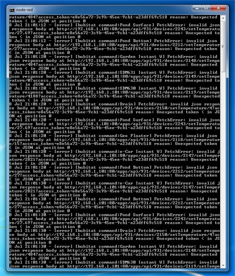

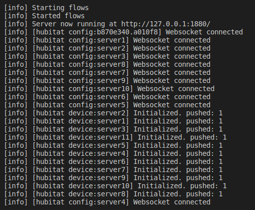

Unfortunately, I tried to reproduce, but without success. I guess I don't trigger the same error that you have. For this I would need to have log (see the quote) of your error. You should be able to re-trigger with a FULL deploy or restart node-red.
I also tried to have 11 connections to websocket, but it didn't cause any issue
Thank you for trying. I will monitor and try to capture a better log. Last night I was seeing the error consistently. I'm just running NR on a Pi 3b and maybe it's struggling given it's also processing my dashboard.
Your error looks like what I already observed when I did benchmark with simultaneous requests on HE.

There were no particular errors in my log, including my NR devices. But I did not activate the Maker API logging debugging (changed that at the moment). I got another set of errors (photo). I will check the next day if I also have other errors.

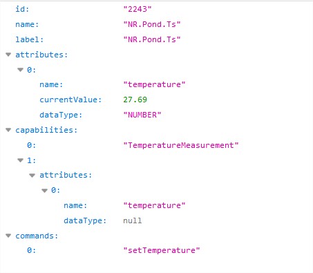

You can try to go to the URL specify to see what is the response you have?
All response I saw, was JSON and the node parse the output with JSON. But maybe some driver doesn't return JSON response .
In this case, the node should be improved to try to catch exception and return response without decoding
I put the logging ON for Maker API and I didn't have any error. the "functions" are called without problems. So, I'll stick to that for the moment because all is working, and that's matter (whatever the command prompt messages).

No I just need you to type the URL (from your log) in your browser and send me the result
It seems related to the fact that code try to decode result to JSON
