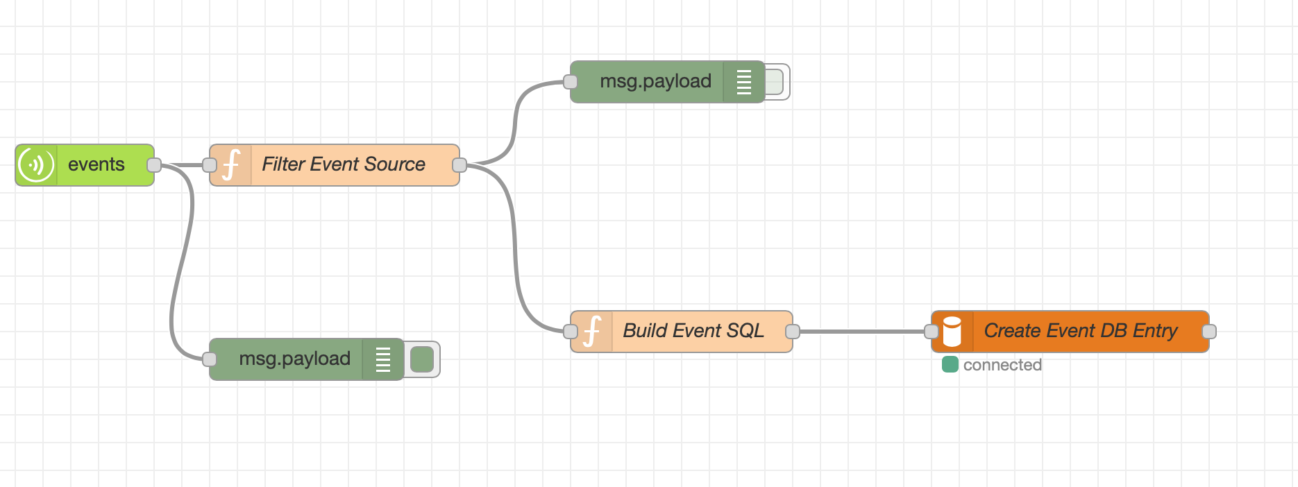

Basic Logic: Listen for events published by the MakerAPI, filter out events that I don't want to log (e.g. illuminance, temperature, power etc.), build the SQL statement and create an entry in a MySQL database. I created a bunch of virtual switches that get turned on/off by the automations and I use those the naming convention of "Virtual..." to log an automation event (I could not find a way to capture when an app executed, hence this workaround).

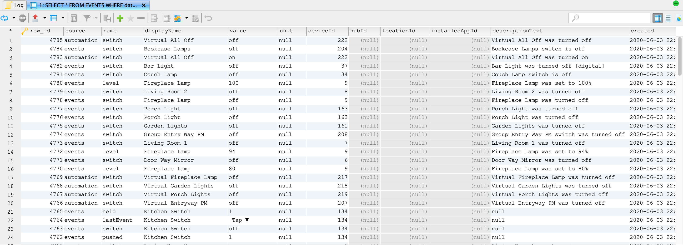

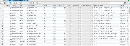

Actual Database Entries:
Questions/feedback requests:
  1. Areas for improvement? I haven't built in any error handling as yet, so any suggestions on how to handle that would be great
  2. Is returning "null" if I want to stop the flow (filter script) an acceptable way? I tried to use a switch with no connector on one output, but I wasn't sure if that was the right way either.
  3. Is there any downside to creating virtual switches? I don't expect to have a ton of devices (as yet!) - just need to move two door locks (Kwikset Z-Wave) and a garage door (GoControl) over, so will end up with about 25 or so actual devices and about 15-20 virtual devices.
Thanks for your help.
I'd go put this in the big node red thread.
I don't see anything wrong with what you did. I would likely have just included return (followed by nothing) and put return message in an else, but I don't think there is anything wrong with either approach. If you aren't sure you can always attach a debug node to the output and see what is coming out.
I will defer to your design on the validity of the SQL, but I assume that it is working in your testing.
Regarding error handling, this is something I should do more of, but for something this simple it may not matter unless you view the info as so vital that you want to jump through lots of hoops if something goes wrong.
Finally, I use a fair number of function nodes myself, but there are many that would point out that everything that you have done here can be done with standard nodes. I wouldn't bother figuring out exactly how, but I think it would be split, switch, join, change nodes to do what you did with those 2 function nodes.
