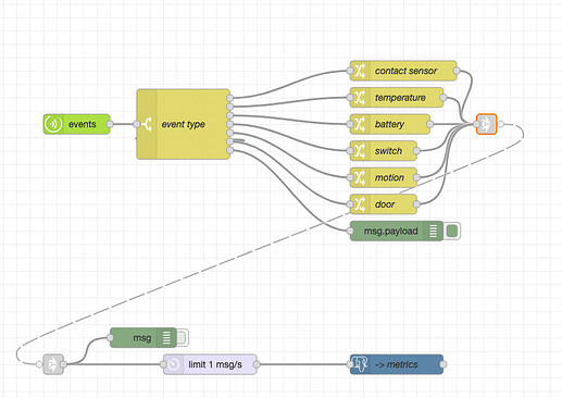

Archiving System-Wide Sensor Data for long term trend analysis:
Here's something I've been enjoying. I slurp up all events from Hubitat and dump them into a metrics table in Postgres. Then a Graphana instance can render dashboards which allow me to scroll back through time, build helpful visualizations, etc.
I used a link-out/in pair between the even receiver and the postgres node because I also manually dispatch events from elsewhere through the same postgres node.
