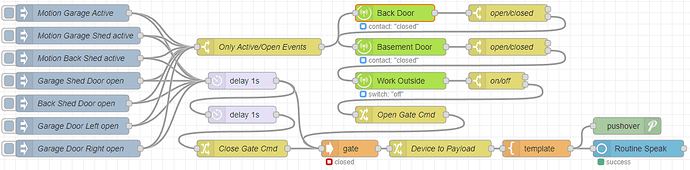

Pictures are nice but with all the "fine" details in nodes I find the actual code better.

I agree although a quick glance at your sequence definitely shows the overall structure/logic which is nice and could be helpful to some people. You can also get creative with Node names to be even more clear... but that is wayyy to close to actually documenting things... :grimacing: and NOBODY wants that! :rofl:

So here's my final working version with help from @aaiyar & @erktrek.
Comments, suggestions, improvements welcome.

@kuzenkohome good job on this flow. I used something like this but no where closed to what you did, just want to thank you for sharing. What is the node that your are using for the "gate"?
Simple Gate.

I curious - why do you use the simple gate node in your sequence?
It allows the original device message (if the gate is open, and so I know which sensor was tripped) to get to Alexa and pushover for notifications.
rather than use the gate, you might try just sticking the device in a flow variable and then recalling it when you send it to pushover.
@kuzenkohome - this is one way to do it. Or directly use "msg.topic" while constructing your Pushover message. It will contain the name of the originating device.
i think msg.topic would have the name of the last device in the chain (doesn't msg.topic default to the device name?). either way, you could certainly use a msg.variable rather than a flow.variable.
Yes, that is correct. So it would have to be assigned to a variable as you suggested.
Alternatively (my preference) to put all device states into flow variables, and then just use switch nodes in place of a device node and a switch node. In this scenario, the original msg.topic would be retained.
