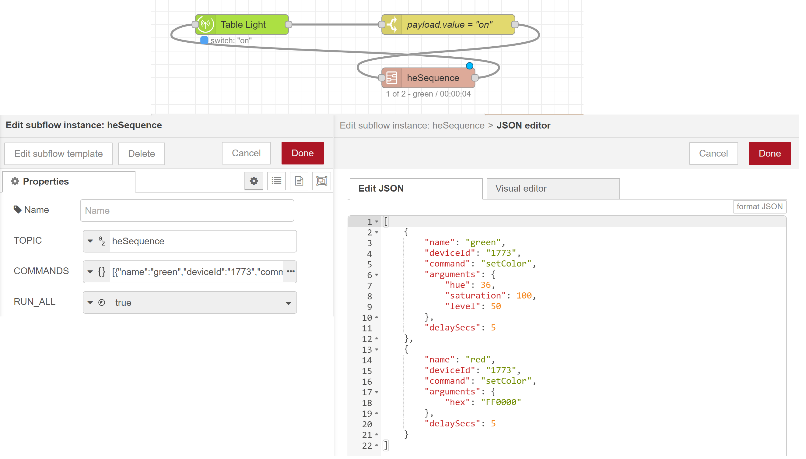

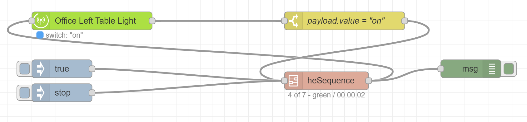

I'd like to offer my simple subflow that can handle a sequence of commands... You can either pass one message to the subflow with RUN_ALL set to "true" and it will automatically progress through the list of commands returning a joined result array message OR multiple times with RUN_ALL set to "false" which allows a step by step approach, with each new message progressing though the list and rolling over to the first command.
This is just the subflow with a bogus HE Config..
Simple Command Sequencer - heSequence (updated)
[{"id":"bd405dcfd9263255","type":"subflow","name":"heSequence","category":"","in":[{"x":50,"y":30,"wires":[{"id":"6ec468a9c0b0abf9"}]}],"out":[{"x":1140,"y":60,"wires":[{"id":"faa1f62b019404a1","port":1},{"id":"3b80fac98ba1259c","port":0}]}],"env":[{"name":"TOPIC","type":"str","value":"heSequence"},{"name":"COMMANDS","type":"json","value":"[{\"name\":\"green\",\"deviceId\":\"1773\",\"command\":\"setColor\",\"arguments\":{\"hue\":36,\"saturation\":100,\"level\":50},\"delaySecs\":5},{\"name\":\"red\",\"deviceId\":\"1773\",\"command\":\"setColor\",\"arguments\":{\"hex\":\"FF0000\"},\"delaySecs\":5}]"},{"name":"RUN_ALL","type":"bool","value":"true"}],"meta":{},"color":"#DDAA99","status":{"x":1140,"y":280,"wires":[{"id":"a840e3a34d7b74c5","port":0}]}},{"id":"be25f6810307808d","type":"function","z":"bd405dcfd9263255","name":"set device command","func":"//commands = msg.payload;\ntopic = env.get(\"TOPIC\");\ncommands = env.get(\"COMMANDS\");\n//node.warn(commands);\n\nvar len = commands.length;\n\nvar current = flow.get(\"current\");\nif (current === undefined ){\n    current = 0;\n}\nif( current < (len-1)) {\n    current++;\n} else {\n    current = 0;\n}\nflow.set(\"current\",current);\n\nvar command = commands[current];\n\nvar retMsg = {\n    \"topic\": env.get(\"TOPIC\")\n    ,\"name\": command.name\n    ,\"command\": command.command\n    ,\"delay\": command.delaySecs\n    ,\"deviceId\": command.deviceId\n}\n\nif (command.arguments!==\"\") {\n    var val = typeof command.arguments == \"object\" ? JSON.stringify(command.arguments) : command.arguments;\n    retMsg.arguments = val;\n}\n\nflow.set(\"statusMsg\", retMsg);\n\nreturn retMsg;\n\n/*\nvar keys = Object.keys(command);\nconst ignore = new Set([\"delaySecs\",\"name\",\"deviceId\"]);\n\nfor (var i=0;i<keys.length;i++){\n    var key = keys[i];\n    if( !ignore.has(key) ){\n\n        if (command[key]===\"\") {\n            retMsg = {\n              \"topic\": topic\n              ,\"command\": key\n              , \"payload\": \"\"\n              ,\"deviceId\": command.deviceId\n              ,\"delay\": delay\n            } \n        } else {\n            var val = typeof command[key] == \"object\" ? JSON.stringify(command[key]) : command[key];\n            \n            retMsg = {\n              \"topic\": topic\n              ,\"command\": key\n              ,\"arguments\": val\n              , \"payload\": \"\"\n              ,\"deviceId\": command.deviceId\n              ,\"delay\": delay\n            } \n            \n        }\n        \n        flow.set(\"statusMsg\", retMsg);\n        node.send(retMsg);\n        node.done();\n    }\n}\n\nreturn retMsg;\n*/\n","outputs":1,"noerr":0,"initialize":"","finalize":"","libs":[],"x":380,"y":140,"wires":[["eb6265f63788fd28"]]},{"id":"a840e3a34d7b74c5","type":"change","z":"bd405dcfd9263255","name":"","rules":[{"t":"set","p":"payload","pt":"msg","to":"\t($flowContext(\"current\") + 1) & \" of \" & $count($env(\"COMMANDS\")) & \" - \" & $flowContext(\"statusMsg\").name\t& \" / \" & payload\t","tot":"jsonata"}],"action":"","property":"","from":"","to":"","reg":false,"x":920,"y":320,"wires":[[]]},{"id":"88ee93fe62787abb","type":"stoptimer-varidelay","z":"bd405dcfd9263255","duration":"5","durationType":"num","units":"Second","payloadtype":"num","payloadval":"0","name":"","reporting":"every_second","persist":false,"ignoretimerpass":false,"x":700,"y":220,"wires":[["faa1f62b019404a1"],[],["a840e3a34d7b74c5"]]},{"id":"faa1f62b019404a1","type":"switch","z":"bd405dcfd9263255","name":"$RUN_ALL?","property":"$env(\"RUN_ALL\")","propertyType":"jsonata","rules":[{"t":"true"},{"t":"false"}],"checkall":"true","repair":false,"outputs":2,"x":930,"y":140,"wires":[["99f2e3e687f1528d"],[]]},{"id":"99f2e3e687f1528d","type":"switch","z":"bd405dcfd9263255","name":"Not Done?","property":"( $count($env(\"COMMANDS\")) != ($flowContext(\"current\") + 1))\t","propertyType":"jsonata","rules":[{"t":"true"},{"t":"false"}],"checkall":"true","repair":false,"outputs":2,"x":350,"y":60,"wires":[["be25f6810307808d","0fd3311ee7ba1738"],["0fd3311ee7ba1738"]]},{"id":"0fd3311ee7ba1738","type":"join","z":"bd405dcfd9263255","name":"","mode":"auto","build":"object","property":"payload","propertyType":"msg","key":"topic","joiner":"\\n","joinerType":"str","accumulate":"false","timeout":"","count":"","reduceRight":false,"x":670,"y":60,"wires":[["3b80fac98ba1259c"]]},{"id":"eb6265f63788fd28","type":"hubitat command","z":"bd405dcfd9263255","deviceLabel":"","name":"","server":"623daead.b1d2b","deviceId":"","command":"","commandArgs":"","x":680,"y":140,"wires":[["78776570158e1106"]]},{"id":"78776570158e1106","type":"function","z":"bd405dcfd9263255","name":"set delay = flow.statusMsg.delay","func":"\nvar statusMsg = flow.get(\"statusMsg\");\nmsg.delay = statusMsg.delay;\n\nvar runAll = env.get(\"RUN_ALL\");\nvar current = flow.get(\"current\");\nvar key = current.toString() + \" - \" + statusMsg.name;\n\nif(runAll) {\n    \n    msg.payload = {\n        \"name\": statusMsg.name\n        ,\"deviceId\": msg.deviceId\n        ,\"command\": msg.command\n        ,\"arguments\": msg.arguments\n        ,\"response\": msg.response\n        ,\"requestCommand\": msg.requestCommand\n        ,\"requestArguments\": msg.requestArguments\n    }\n    \n    msg.parts = {\n        \"id\": env.get(\"TOPIC\"),\n        \"index\": current,\n        \"count\": env.get(\"COMMANDS\").length,\n        \"type\":\"object\",\n        \"ch\":\"\",\n        \"key\": key,\n        \"len\":\"\"\n    }\n}\n\n\n\nreturn msg;","outputs":1,"noerr":0,"initialize":"","finalize":"","libs":[],"x":410,"y":220,"wires":[["88ee93fe62787abb"]]},{"id":"3b80fac98ba1259c","type":"change","z":"bd405dcfd9263255","name":"cleanup msg","rules":[{"t":"delete","p":"command","pt":"msg"},{"t":"delete","p":"deviceId","pt":"msg"},{"t":"delete","p":"arguments","pt":"msg"},{"t":"delete","p":"response","pt":"msg"},{"t":"delete","p":"requestCommand","pt":"msg"},{"t":"delete","p":"requestArguments","pt":"msg"},{"t":"delete","p":"delay","pt":"msg"},{"t":"delete","p":"_timerpass","pt":"msg"},{"t":"delete","p":"name","pt":"msg"}],"action":"","property":"","from":"","to":"","reg":false,"x":930,"y":60,"wires":[[]]},{"id":"6ec468a9c0b0abf9","type":"switch","z":"bd405dcfd9263255","name":"payload != stop","property":"payload != \"stop\"","propertyType":"jsonata","rules":[{"t":"true"},{"t":"false"}],"checkall":"true","repair":false,"outputs":2,"x":120,"y":320,"wires":[["be25f6810307808d"],["014b9b4e013257f2"]]},{"id":"014b9b4e013257f2","type":"change","z":"bd405dcfd9263255","name":"","rules":[{"t":"set","p":"current","pt":"flow","to":"-1","tot":"num"}],"action":"","property":"","from":"","to":"","reg":false,"x":360,"y":320,"wires":[["88ee93fe62787abb"]]},{"id":"623daead.b1d2b","type":"hubitat config","name":"YourHEHub","usetls":false,"host":"[your HE ip]","port":"80","appId":"[your appId]","nodeRedServer":"http://[your nr ip]:1880","webhookPath":"/hubitat/webhook_","autoRefresh":true,"useWebsocket":false,"colorEnabled":false,"color":"#000000"}]
Warning: still futzing around and there may be a bug or two left. Also notice that in the arguments field it handles the conversion to a JSON string.. When doing a "RUN_ALL" a joined array of command results is returned...
Further Notes:
Forgot to mention - this requires the node-red-contrib-stoptimer-varidelay node - I am using that instead of the "delay" node. Also to stop the the process midway send a msg.payload = "stop".
