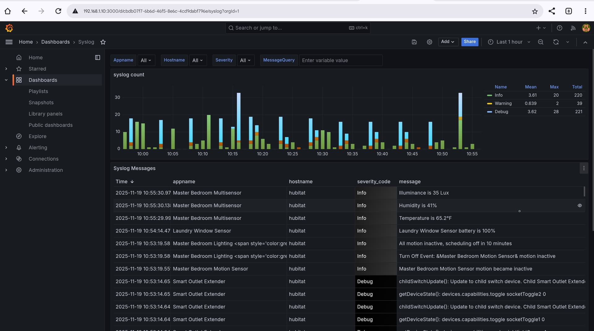

I use the Logs websocket and dump the data into a InfluxDB and use Grafana to view it. Here is an example of my grafana dashboard. I use a driver i wrote to put all log data into InfluxDB for this dashboard.

My process uses a virtual device that uses a websocket to recieve the log events as they happen and then sends them to a external InfluxDB hosted on a home server. It doesn't faile and has code to reconnect to the websocket if for somer eason it looses that. It has worked flawlessly since i set it up. It could probably be modified fairly easy to only send certain types of events as well. At this point i have been using it for years.
