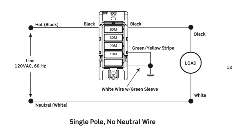

We bought a dumb timer for a new bathroom. fan/light that we installed yesterday. I don’t recall the brand but the device has a dedicated ground and a separate white wire that was in a green sleeve. The instructions indicated that if the wiring to the box didn’t have a neutral that the white wire in the green sleeve ( neutral ) could
Be connected to ground. I’m sure this is probably an electrical code question but is that acceptable to do with a smart switch that requires a neutral?

Green sleeve typically represents a ground wire. White is neutral and black/red are hot.
Fishing a ground from the outlet would work, but cause you some issues as it will create a second circuit. It’s a bit hard to explain, but if you do this, when you turn off the your breaker for the outlets, power will still flow through them via the neutral in some cases, unless you also turn off the breaker that feeds the switch.
No. Not in the US.
Only if they are on the same breaker.
I’m not an electrician, but ground is not neutral, even though both technically will complete a circuit if you connect that white wire to either.
Ground is not supposed to be carrying current on it except for when something goes wrong, like a short circuit, which should then cause the circuit breaker to trip.
I’m not sure about all the potential safety implications of a scenario like that, but clearly it’s safer to avoid entirely.
With a switch there is normally only a black wire which connects and disconnects the hot to the load. With the neutral at the light the return current is still on the neutral.
I think With a smart switch, the neutral Is only returning the current from powering the smart switch electronics….not the load.
But I agree…better safe than sorry and will steer clear and look for the proper device.
I was surprised however that the dumb timer gave us that option to connect the neutral to ground. Must be engineered that way however as I’m guessing Leviton is UL and CSA rated.

I think it is against code to bond neutral and ground anywhere other than the breaker panel. Not sure about Canada.
