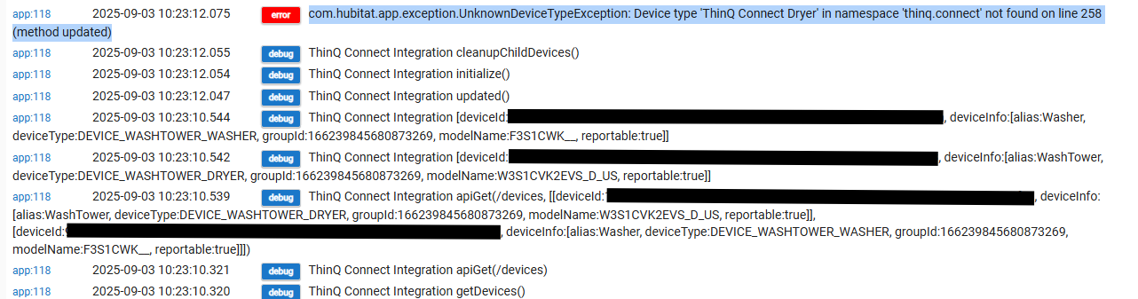

I'm trying to set this up but getting an error in the logs:
com.hubitat.app.exception.UnknownDeviceTypeException: Device type 'ThinQ Connect Dryer' in namespace 'thinq.connect' not found on line 258 (method updated)
I have the washer and dryer device drivers installed. My devices are a combo "Washtower", but I don't know if that matters. They were detected as a separate washer and dryer using the old integration.
The debug logs show:
Any ideas?
Edit: I was able to make it work by changing the namespace in the device driver code from 'jonozzz' to 'thinq.connect' for both the washer and dryer devices. I'm not sure if that's the right way to fix it, or if the namespace reference should be fixed in the app code.

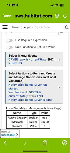

I installed your app and I can see my washer and dryer. I can start and stop them but I get no notifications with my rule. Am I missing something?
I might be wrong but the trigger even has to be true all the time for the actions to execute. I'm not a rule machine expert, but this is how I'd do it:
Trigger Events:
Dryer currentState *changed*
Actions to Run:
IF (Dryer currentState = "RUNNING") THEN
    Send notification: "Dryer is now running."
ELSE-IF (Dryer currentState = "END") THEN
    Send notification: "Dryer cycle has finished."
END-IF
The trigger does not have to remain true for the rule to proceed. The rule you posted should work, but so should the rule the OP posted.
The usual advice applies. Turn on all logging for the rule and info logging for the device and see what gets logged the next time the dryer runs.
That did not fix the problem. I will have to turn on logging. Although last night I did not see any event post when the dryer was running or stopping. So, it seems like it is either not polling the dryer or the dryer is not sending any updates.
That's very odd, you should at least see a currentState transition from POWER_OFF to INITIAL when you flip the power button on the appliance. Can you enable debug logs in both the app and driver and see what you get?
