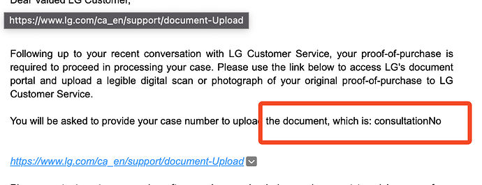

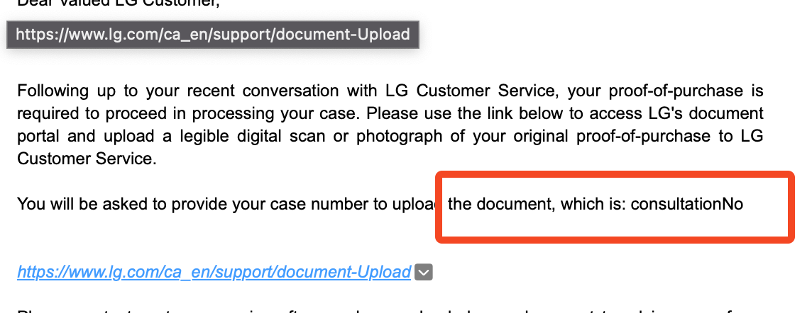

One cannot submit any inquiry to LG without a case number and a prrof of purchase (regardless of what your problem is). But you if cannot log into your account and you never get a case no there is no way you will ever get a response :rofl:
Catch 22 with a twist of sadism :rofl:
PS this was me simply emailing them through their generic form on their website
